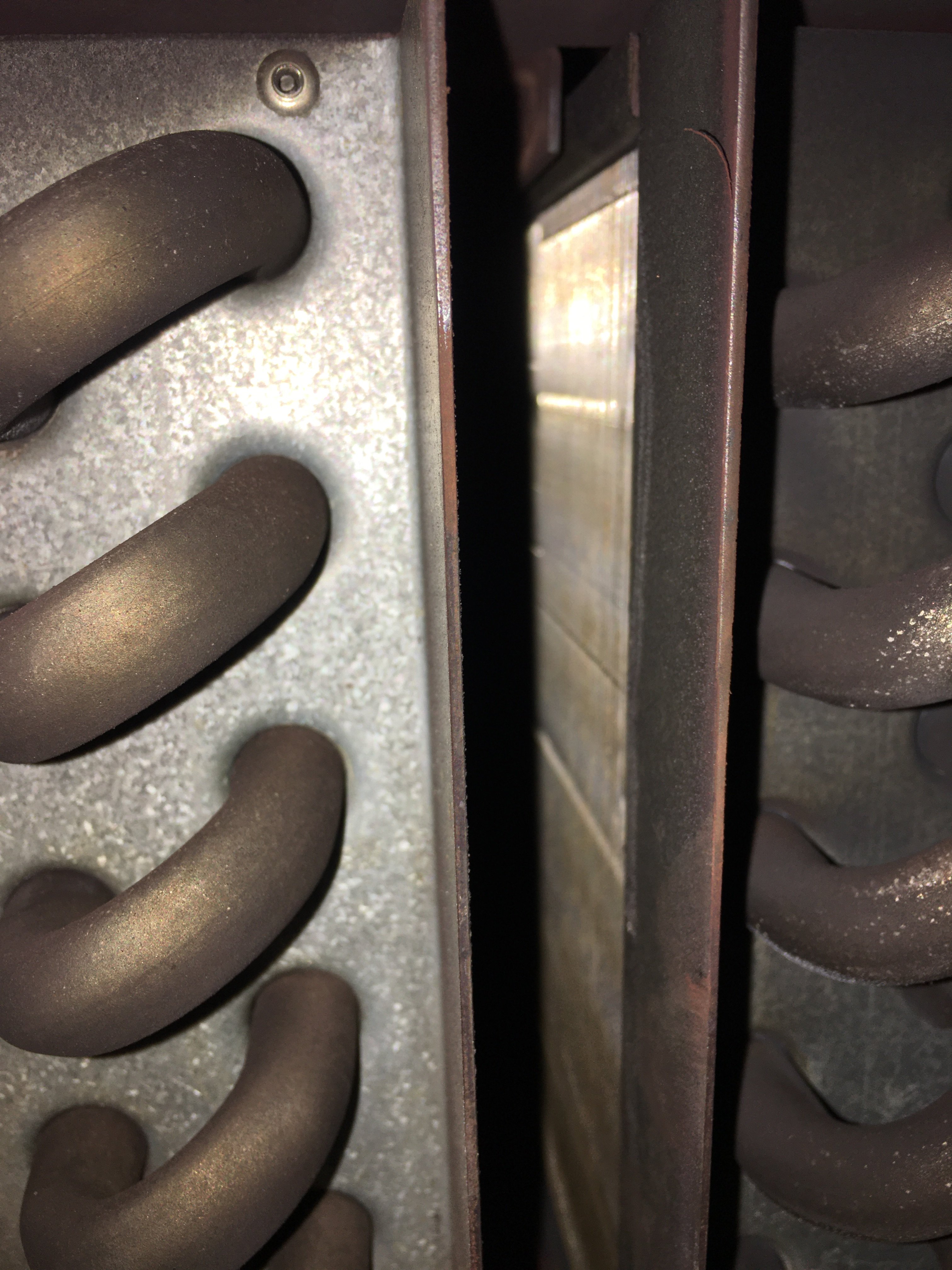

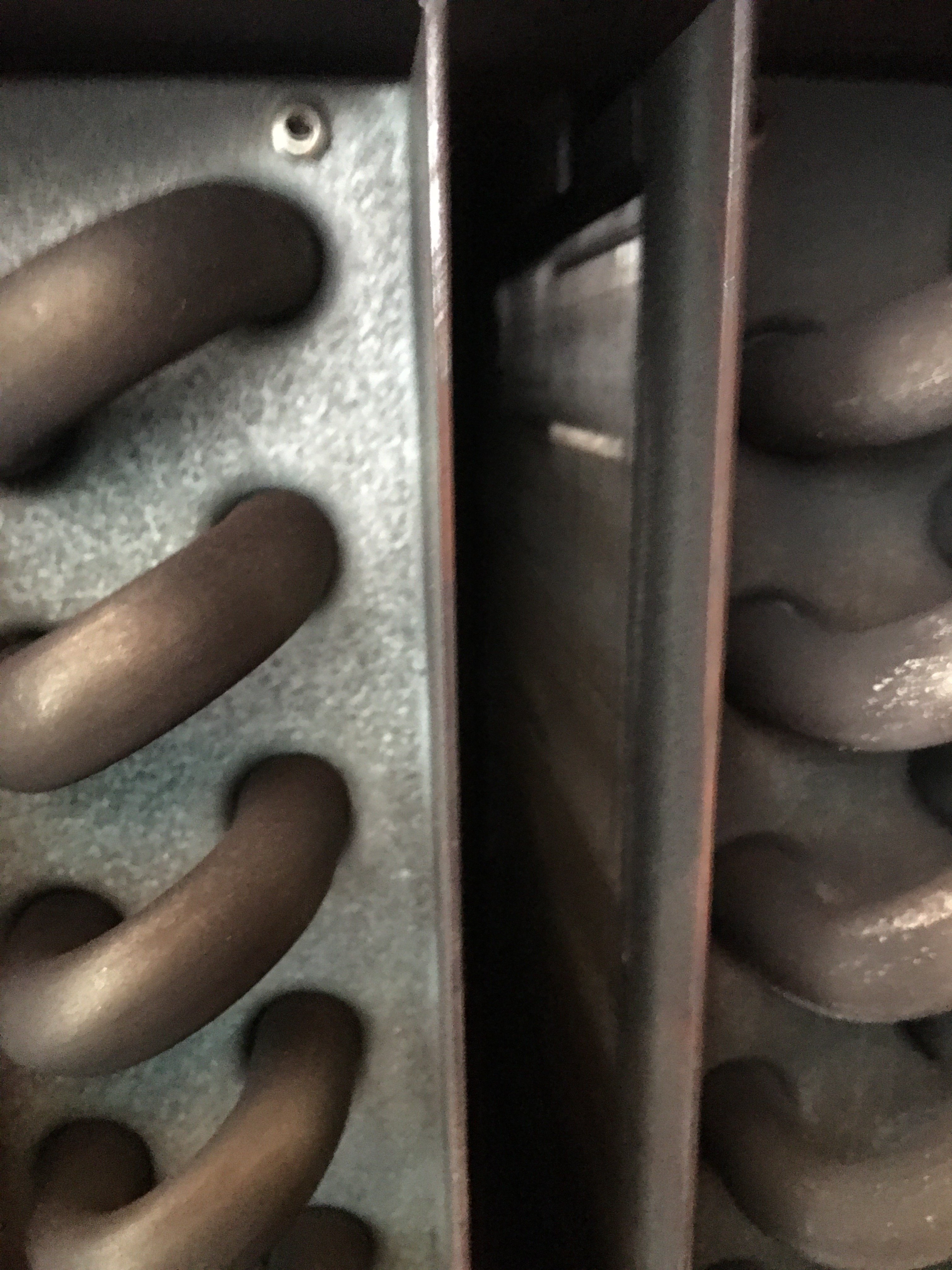

while you have stuff apart maybe clean the exchangers and make sure nothing is choking the intake or discharge....
if you tear the old one down let us know what it looks like on the inside

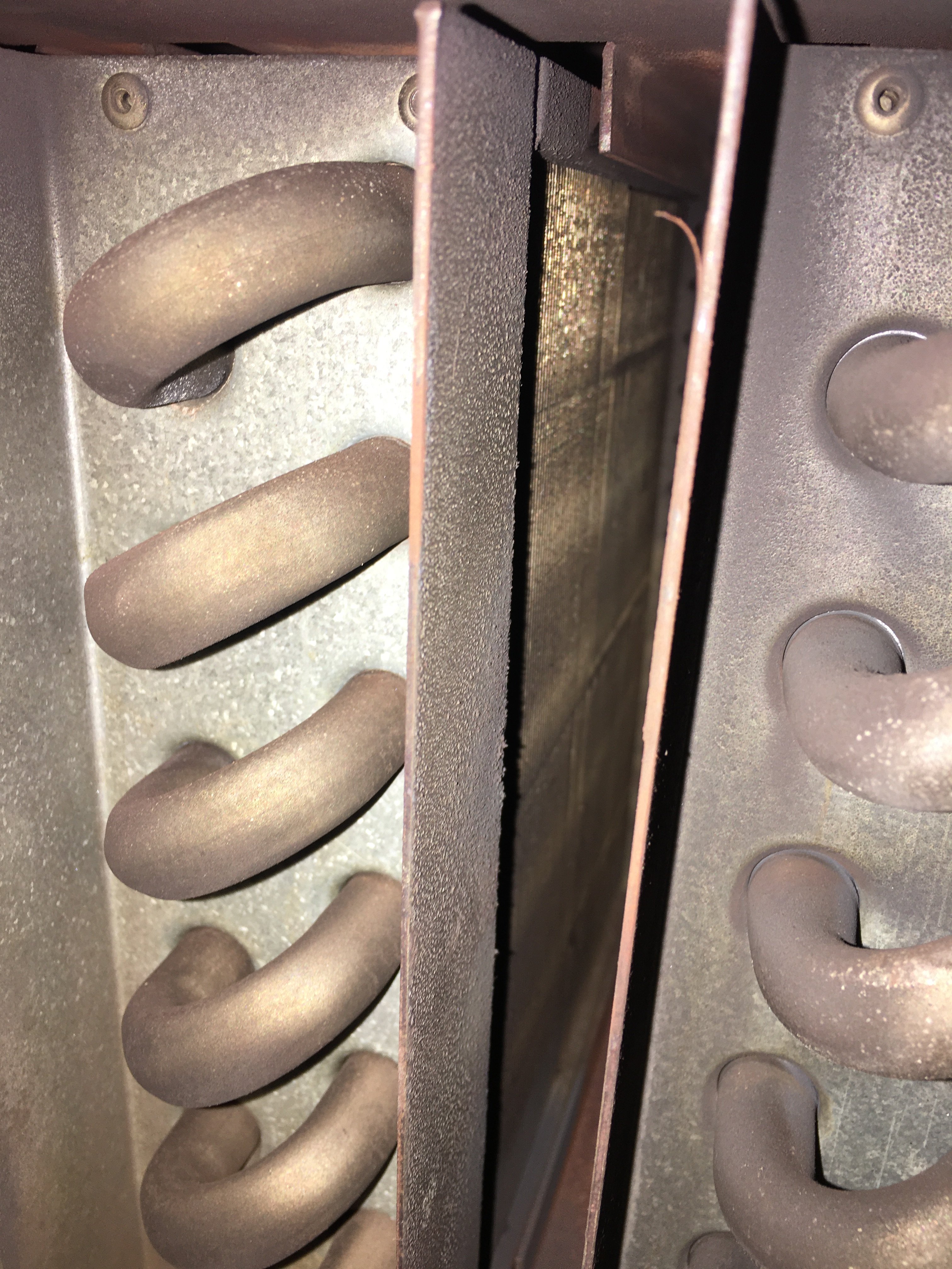

I don’t know how it looks inside the silencer yet, but I opened up the heat exchangers. I see no blockage. I wasn’t able to get a pic of the first fin coil, but I could see through a bolt hole and I noticed no blockage. It breathes fine on this part

I'd probably still make an effort to clean/degrease everything while I had it apart.....reduced back pressure and more heat
I don't know how feasible that is having never played with an everest heat exchanger
14,475
It's a pain getting access to the other side of that heat exchanger. It's not a friendly design down there
14,475
does that coil set not come out....again not familiar
It does, but I have to loosen it on the other side of the heat exchanger, which I have to remove the helicoil heat exchanger to get access.
Reactions: FB19087
14,475
don't be lazy....
I see no blockage. I'm not going to waste any time on something that might cause another problem if I re-install it incorrectly because of the unfriendly location it's in.

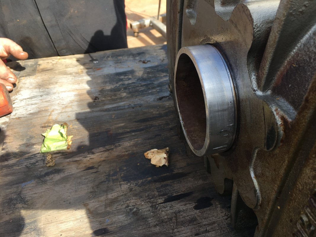

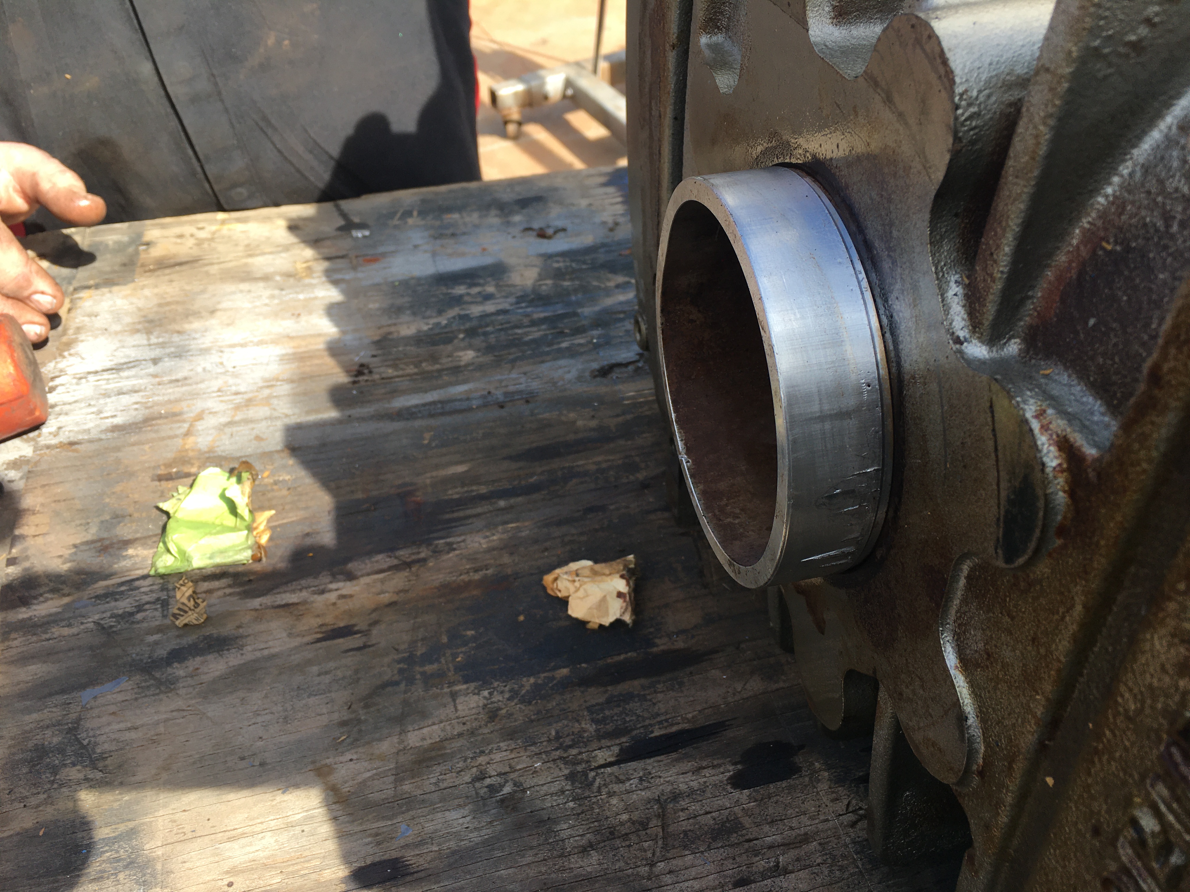

Got the blower out. Can’t remove the bottom pipe, so I’m having a new one made Monday. ☹️

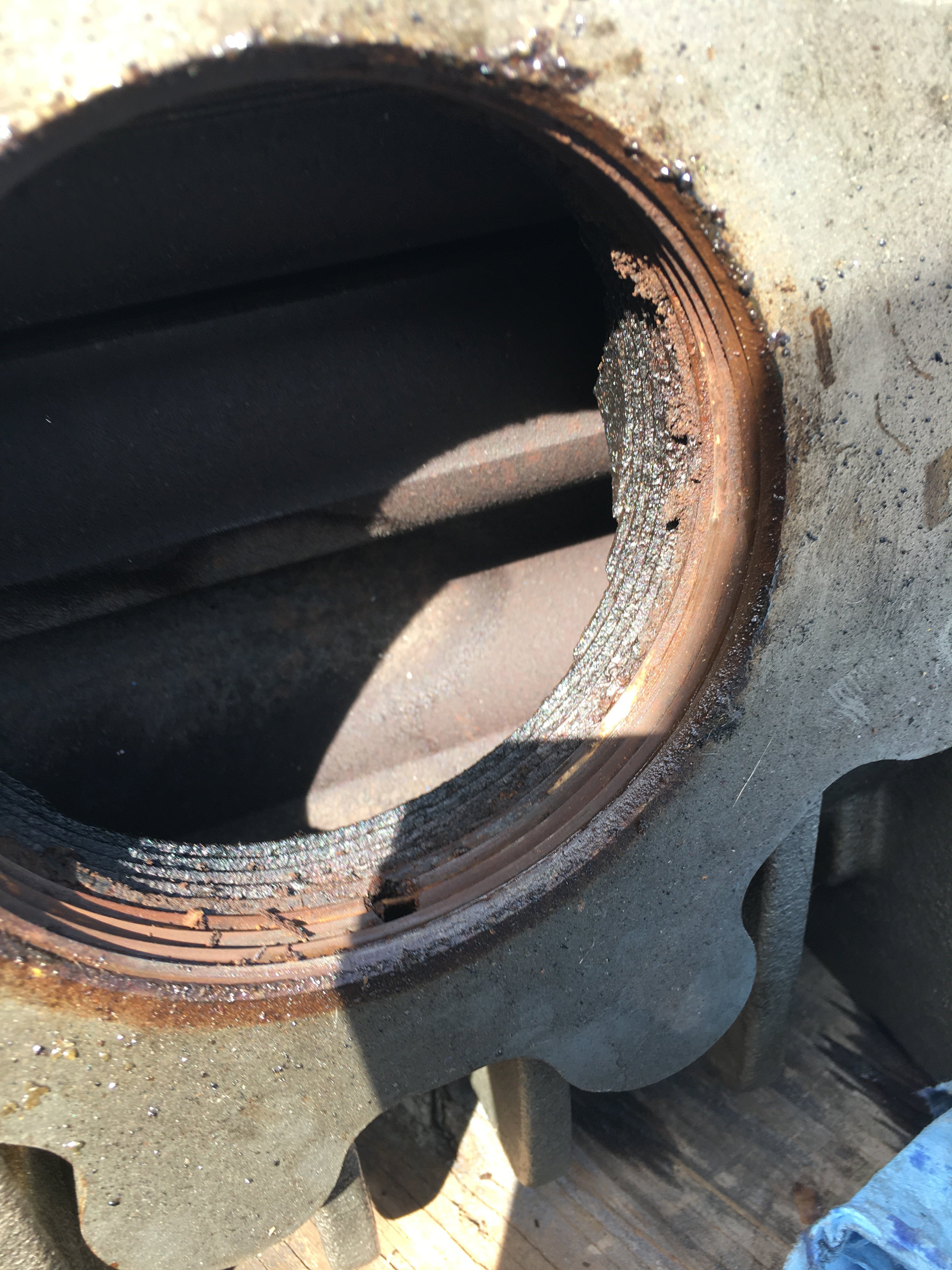

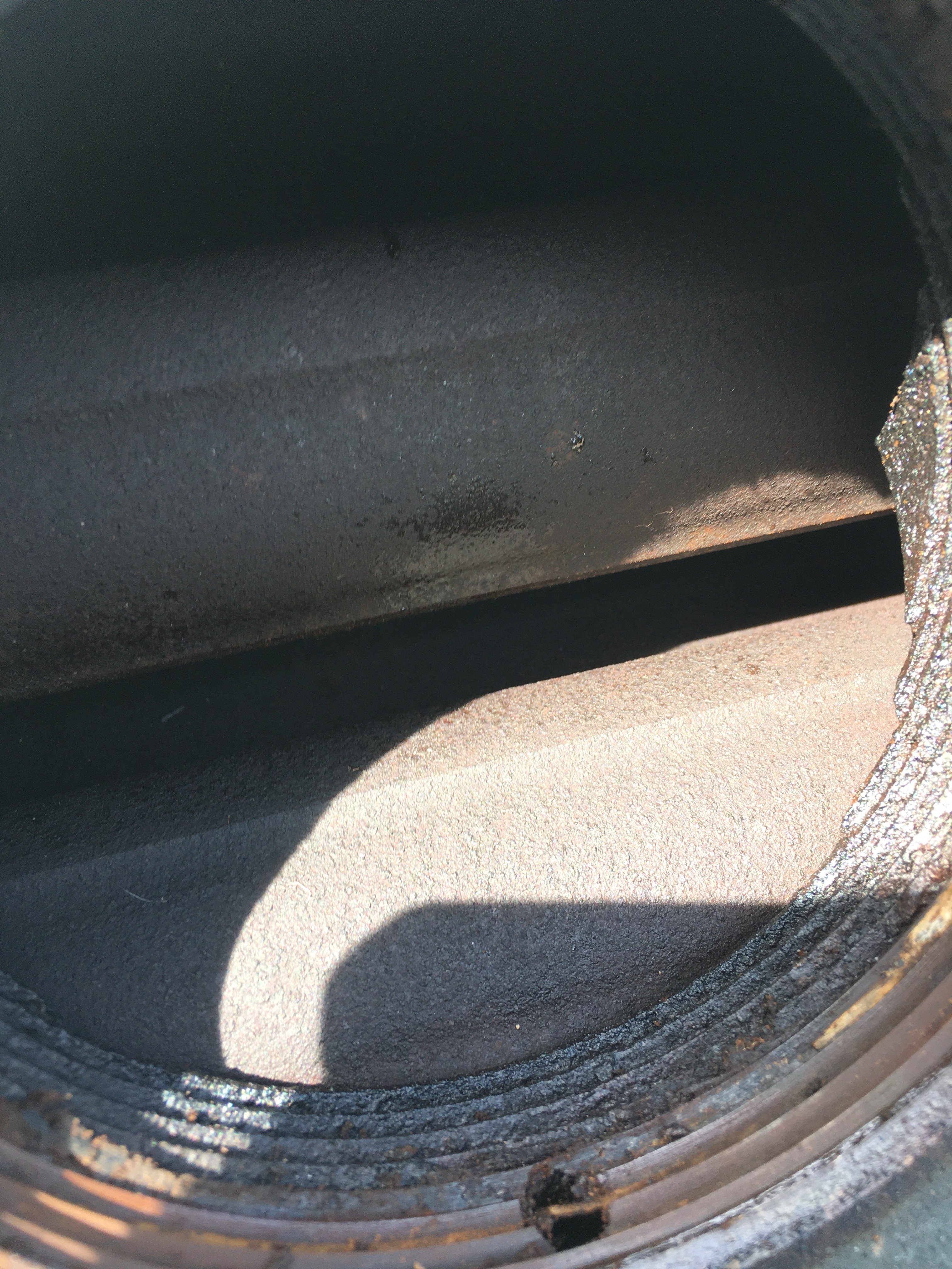

Here’s a couple pics of the lobes. I hear a mild grind when I turn the shaft. I tried moving the shaft side by side and it didn’t have any play this time. Weird
05A347CC-0719-4451-9BA8-FE40F0B52914.jpeg 946BED19-13A3-4E7D-84FB-7C9FBAB72460.jpeg 4FA46CBA-99FC-474B-BB4E-189AE10FD3DC.jpeg
If it just sounds a bit scratchy it’s probably just the rust buildup
but maybe when it heats up there is more interference.............I'd expect more noise though
You clean that heat exchanger yet?
this one?
need to bolt down/secure the blower some how, then a 6ft cheater bar on the pipe wrench
If that doesn't get it, then it's torch and cheater bar
and what good is a new one if you can't get the old one out? :headscratch:
what am I missing Woodrow?
14,475
this one?
Idiot
I have a new blower that the pipe is going in. The one in the picture is the bad blower. And yes, the cheater bar, strapped to the table and a torch was used today. It ain’t budgin
