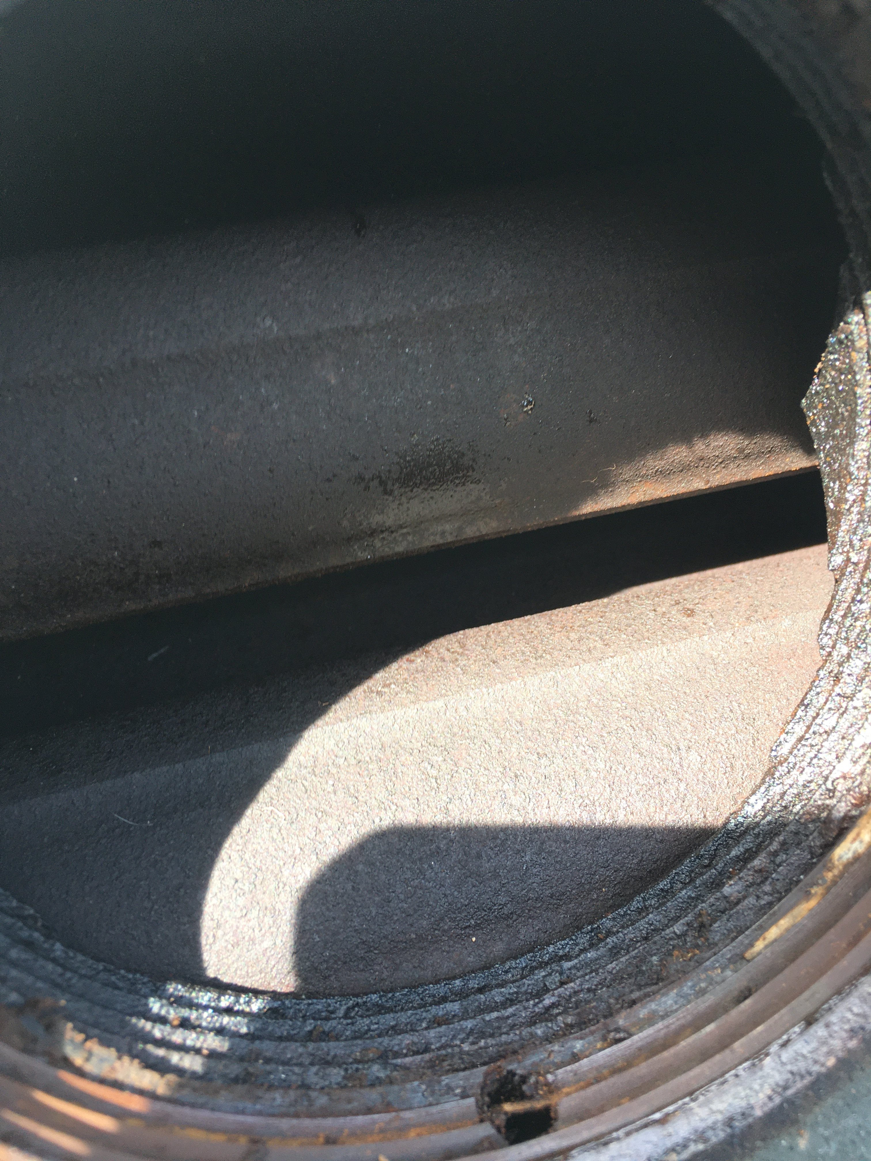

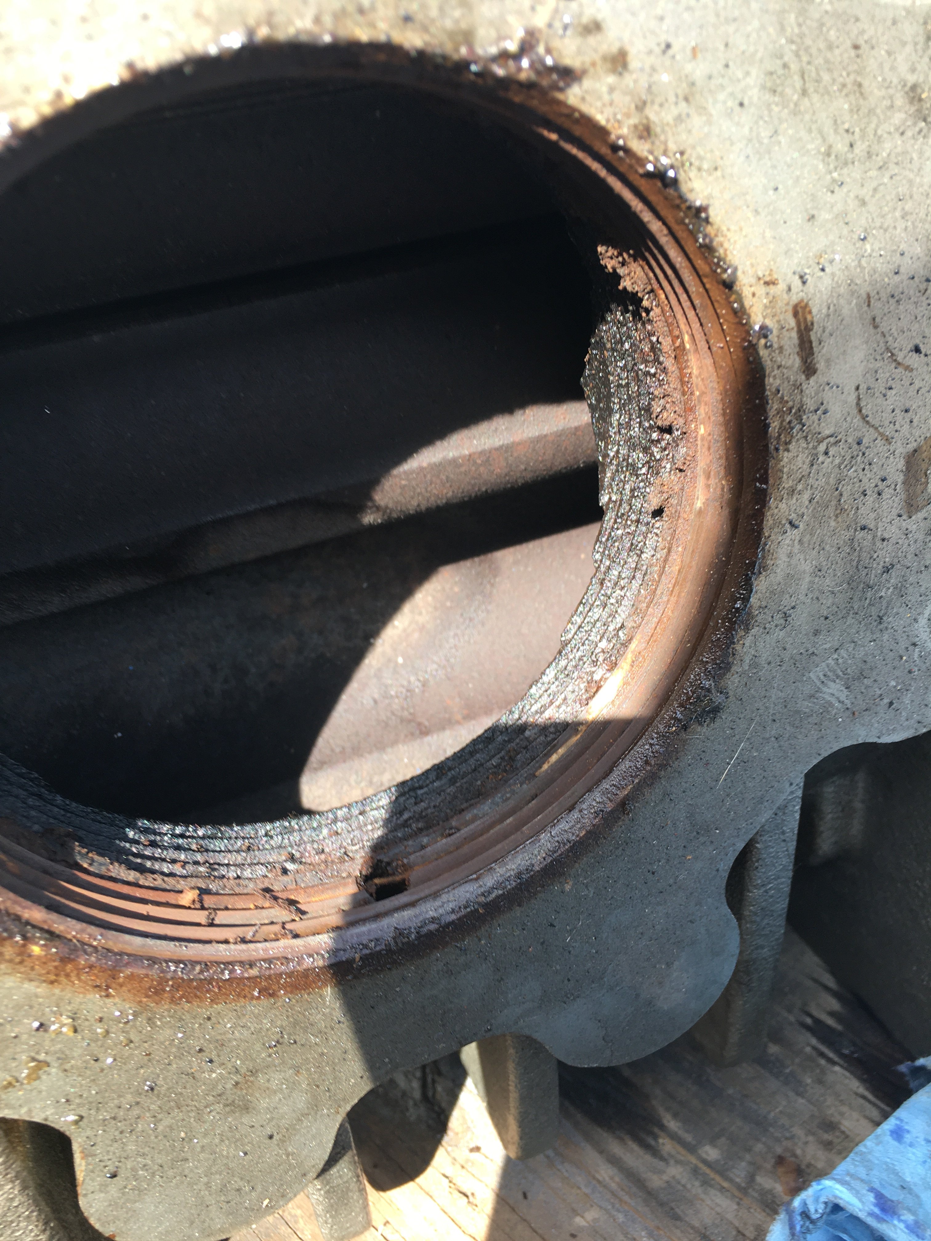

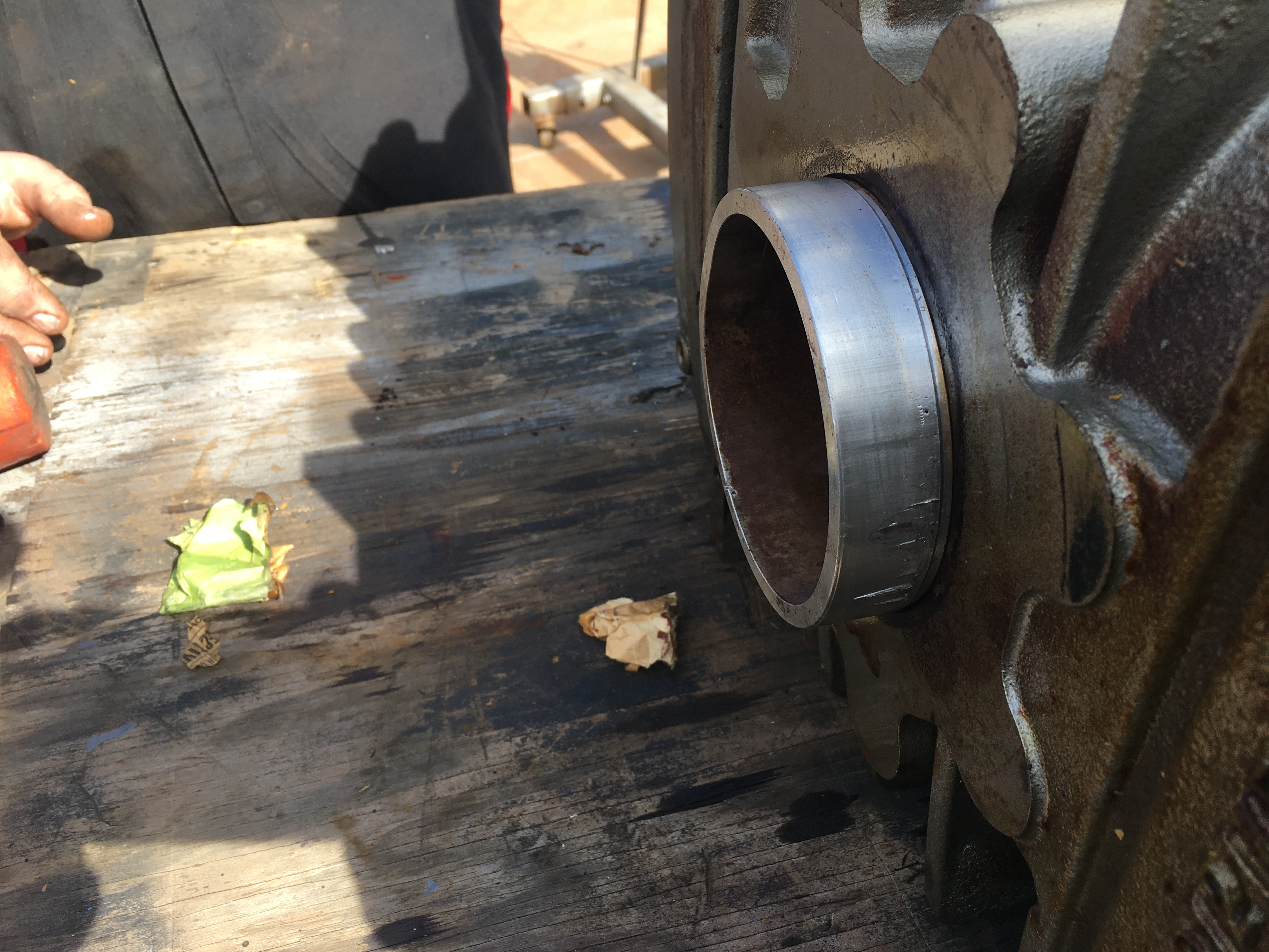

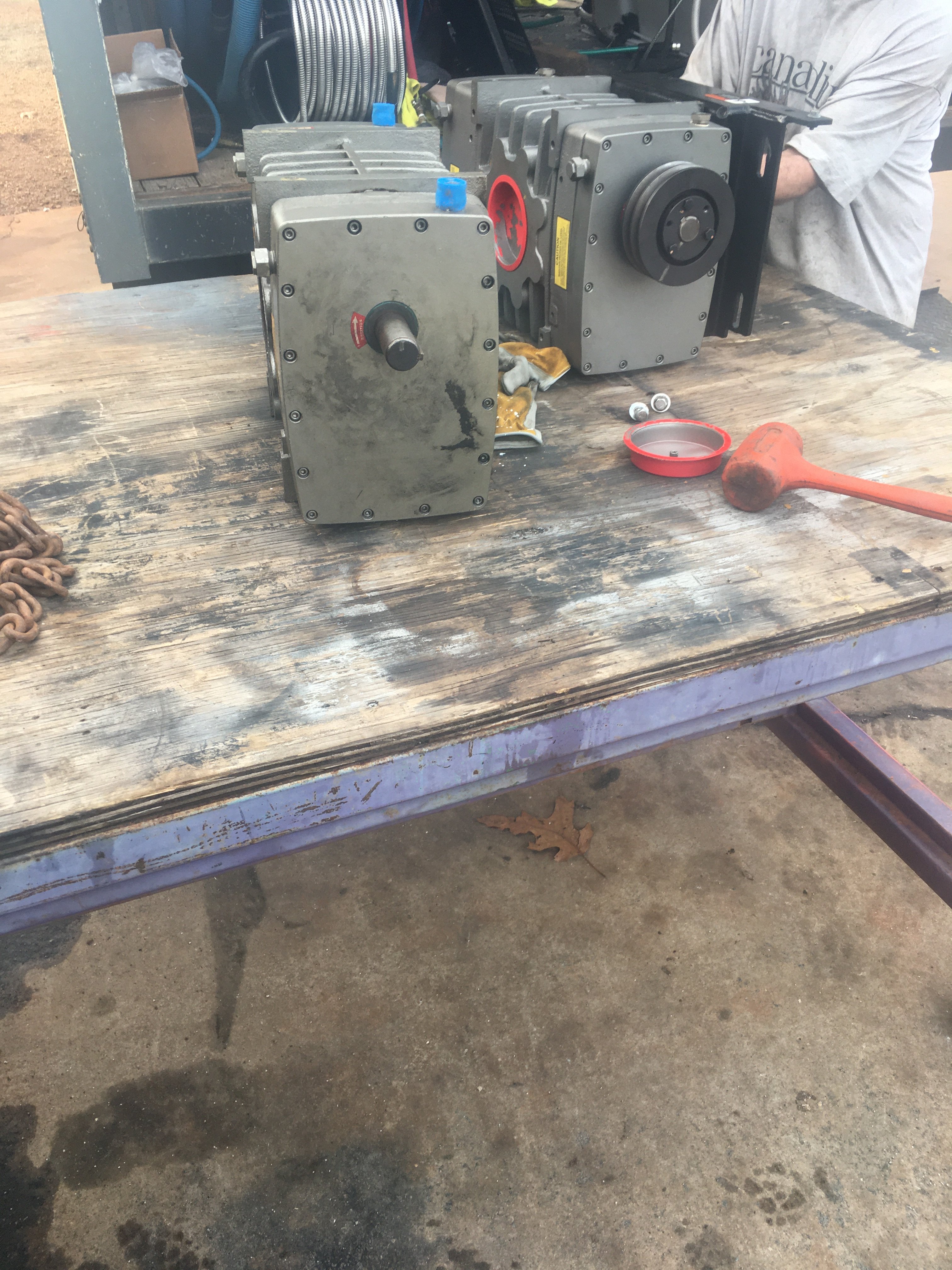

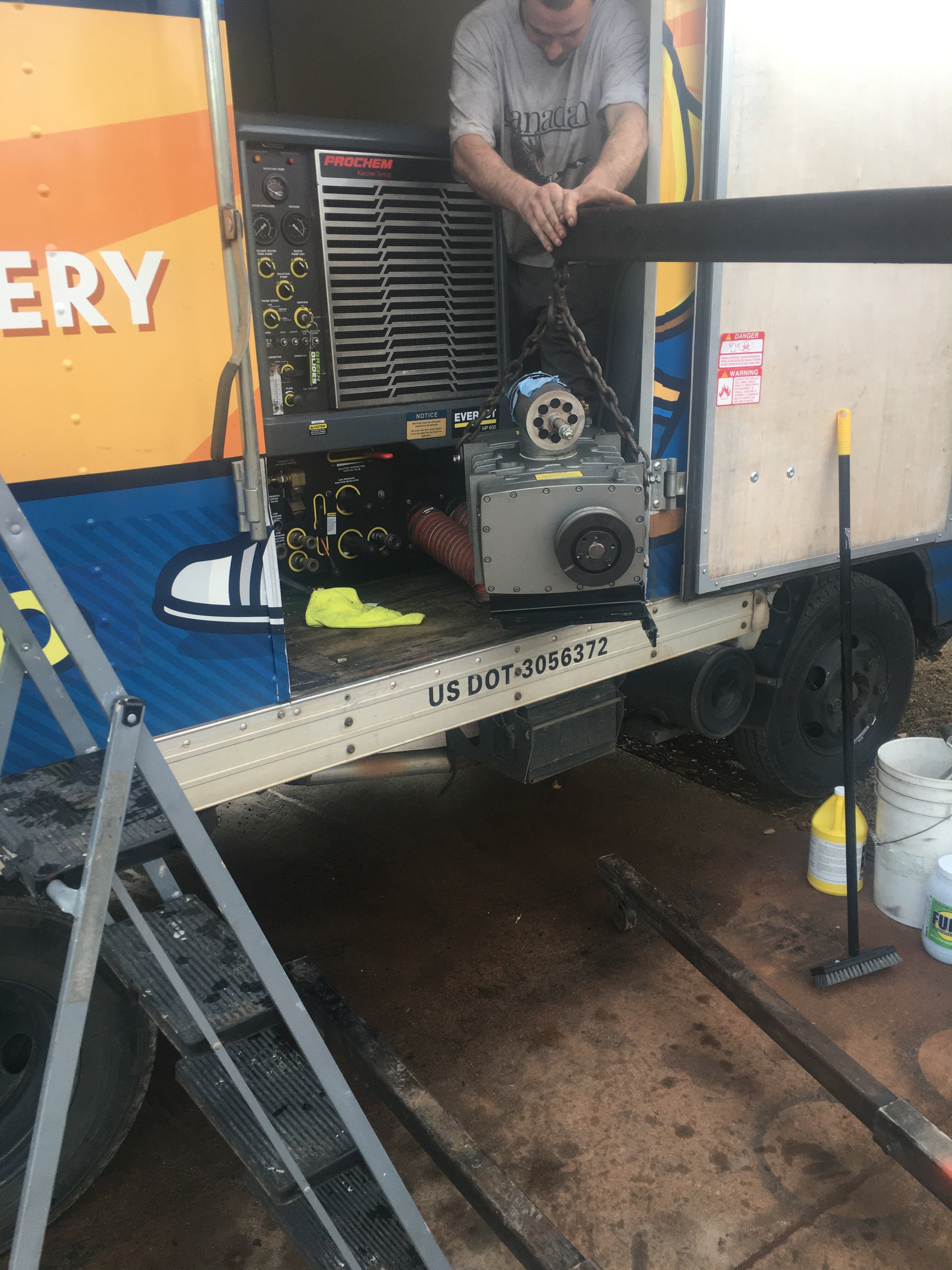

Got the blower out. Can’t remove the bottom pipe, so I’m having a new one made Monday. ☹️
Here’s a couple pics of the lobes. I hear a mild grind when I turn the shaft. I tried moving the shaft side by side and it didn’t have any play this time. Weird
View attachment 120539 View attachment 120540 View attachment 120541
Is there somewhere to send it to be refurbished? The new one is going to drive your quirky A crazy too. You’d love to have to have two blowers to swap out and compare on a multi point chart 😁

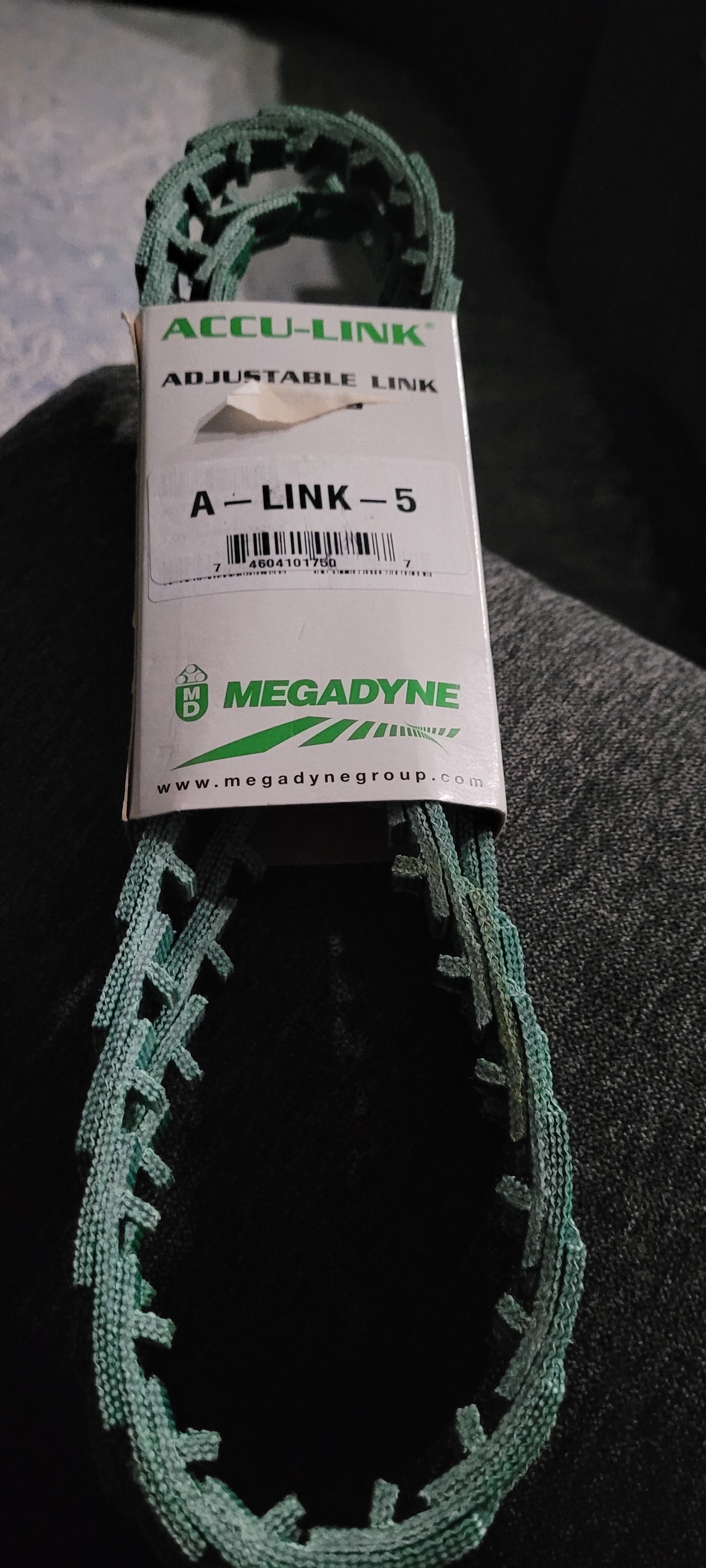

Hello there, I did scroll through many answers, and you've got some sound advice. " Court has ruled on the defective blower." Before you accept that ruling, I want to point out that the positions of shafts (once set correctly) shouldn't be variable unless the blower is removed and set back. On my setup, I'm using TB Woods coupler -8J, and Accu- link belt( I searched history ), and there is no mention of it, so I thought I shared the info. Before starting to use this belt, I found out that this belt is used in many industries, and the foremost benefit is eliminating vibration and desired tension. You have to adjust it ( remove one link at a time) quite often, but after that, you are going strong for months. I have used five belts so far. The Reliabilt unit has 2800 hours. It has an actuary motor to move the Kohler engine ( 2") to replace the coupler, but that's the only occasion. One more thing I learn about my blower. Its favorite lubricant is Super Slick Stuff( it emits a pleasant citrusy scent); it's not dingy as other lubricants.
I hope you'll find this information useful.
