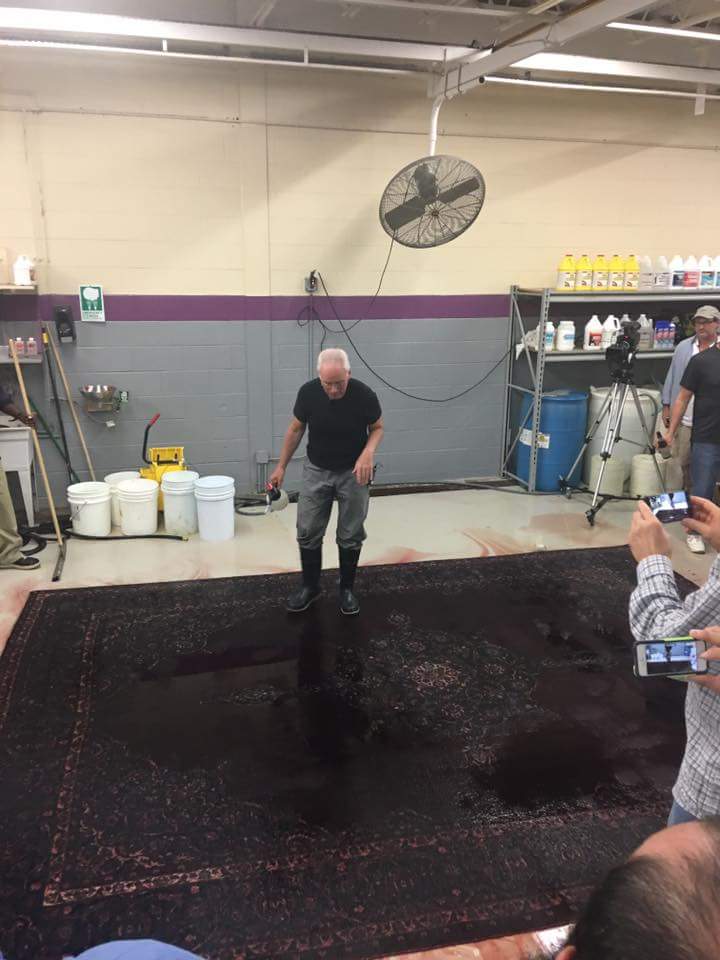

I think a fair comparison of Reduceall and Hydro would be using them the same way plants all around the world use Hydro....in a bucket of hot water poured over the rug, on the wash floor, prior to spinning or extraction.
After watching the video it seems like a ton of product is needed to create the reaction and what your 5 minute video showed could be accomplished on the wash floor in about half the time (depending on how stubborn the dye was being).
Larry Cobb
5,795
Larry Cobb
We used 2 oz. of ReduceAll in 2 gallons of 130 degree water.
The rug bleeding was dried completely before the removal.

Rug Summit 10 on Thursday with Robert Mann providing the demonstration
