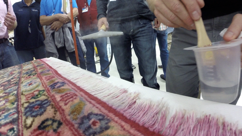

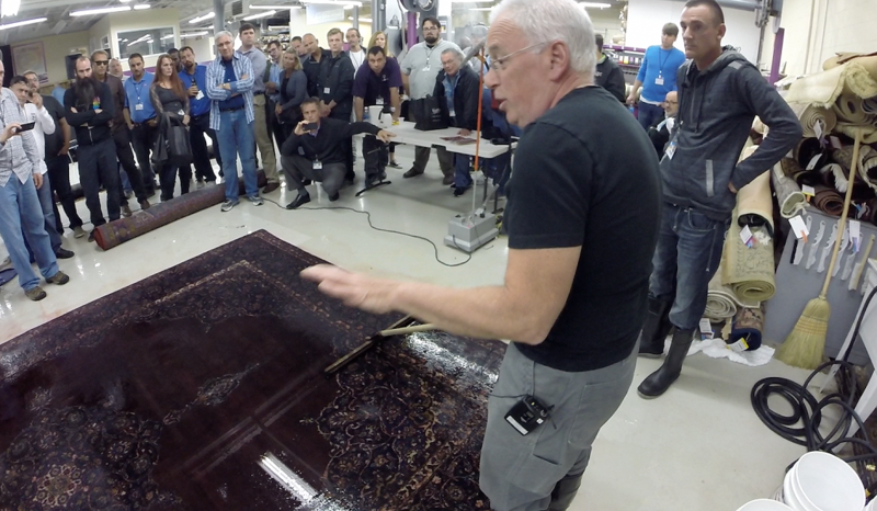

This topic is the Main reason I'm sending my tech to Rug Summit 10 next week. We were TAUGHT the remedy at Robert Mann's Last year... This time he will listen and participate more actively in an effort to LEARN the remedy.
Demo at Rug Summit 10:

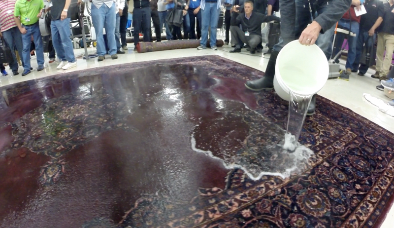

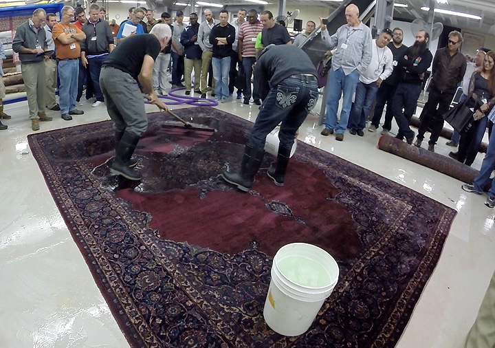

Did your tech learn something?
Was it worth the expense to come to Rug Summit?

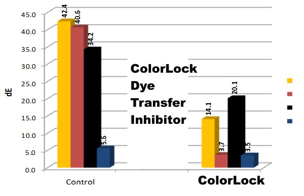

David S.- "How many different dyes have you tested on to make such a statement?"
Here is some technical testing of the ColorLock after washing.
Red Dye Transfer was reduced in the wash to 9% of the control bleeding on white fiber.
