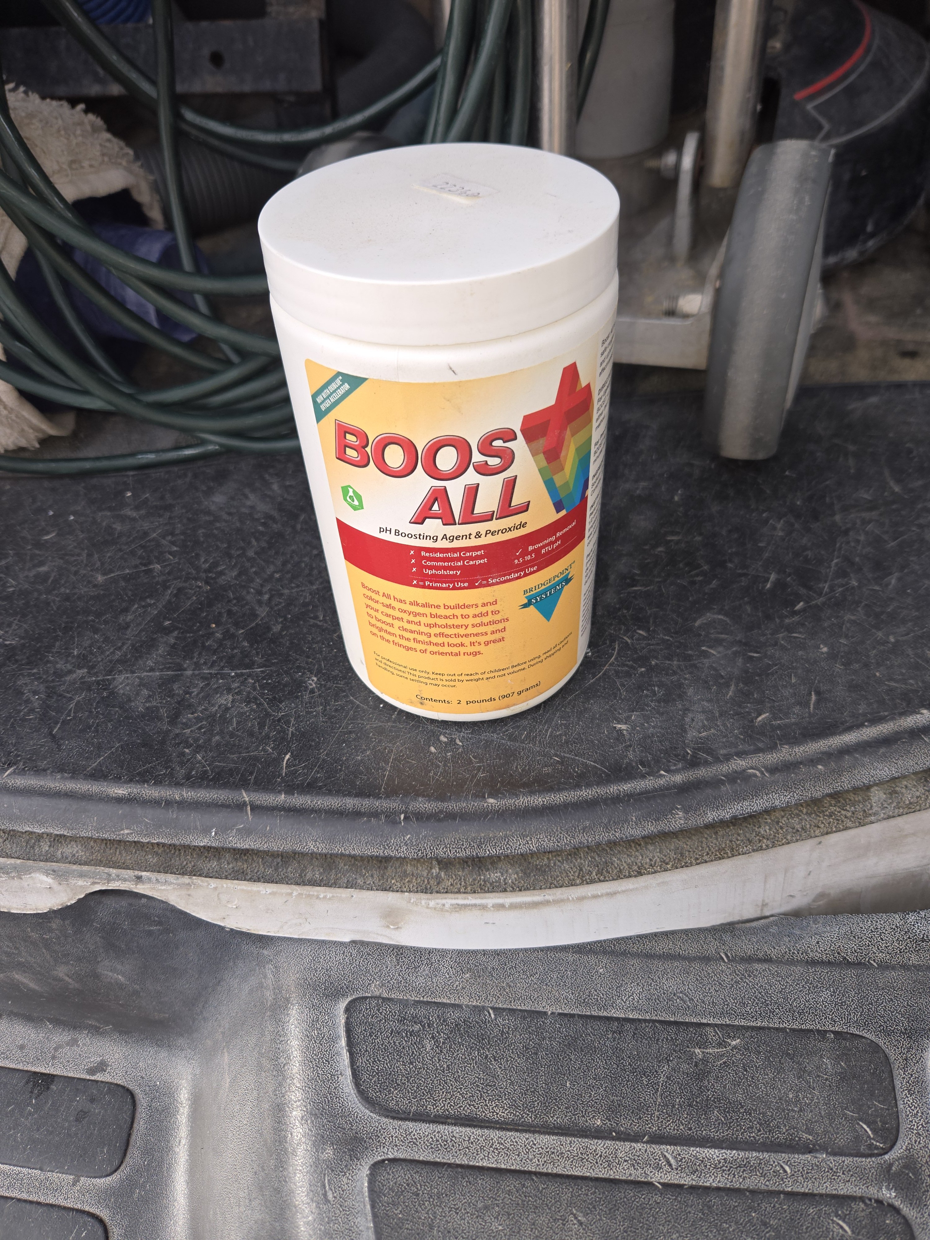

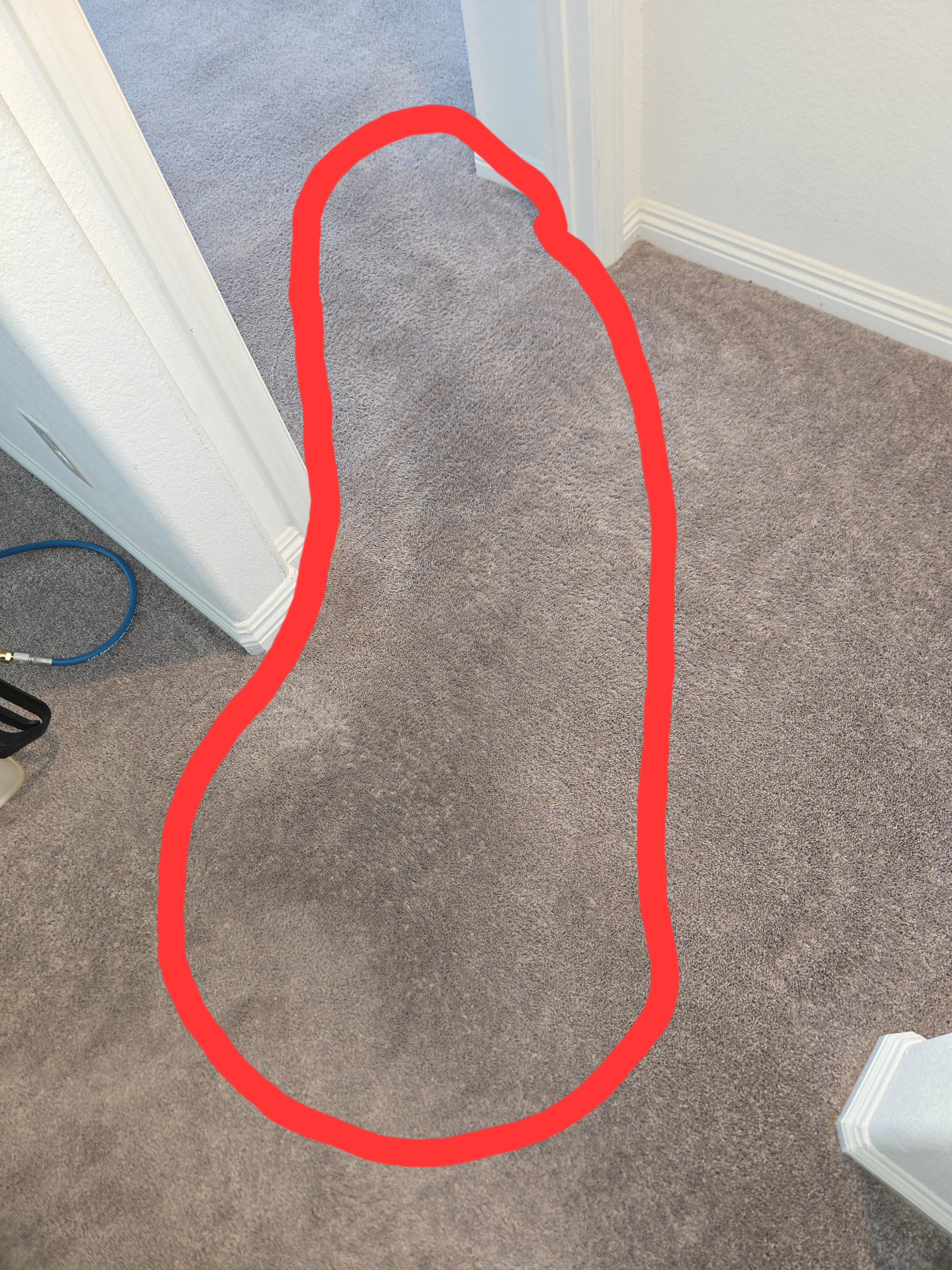

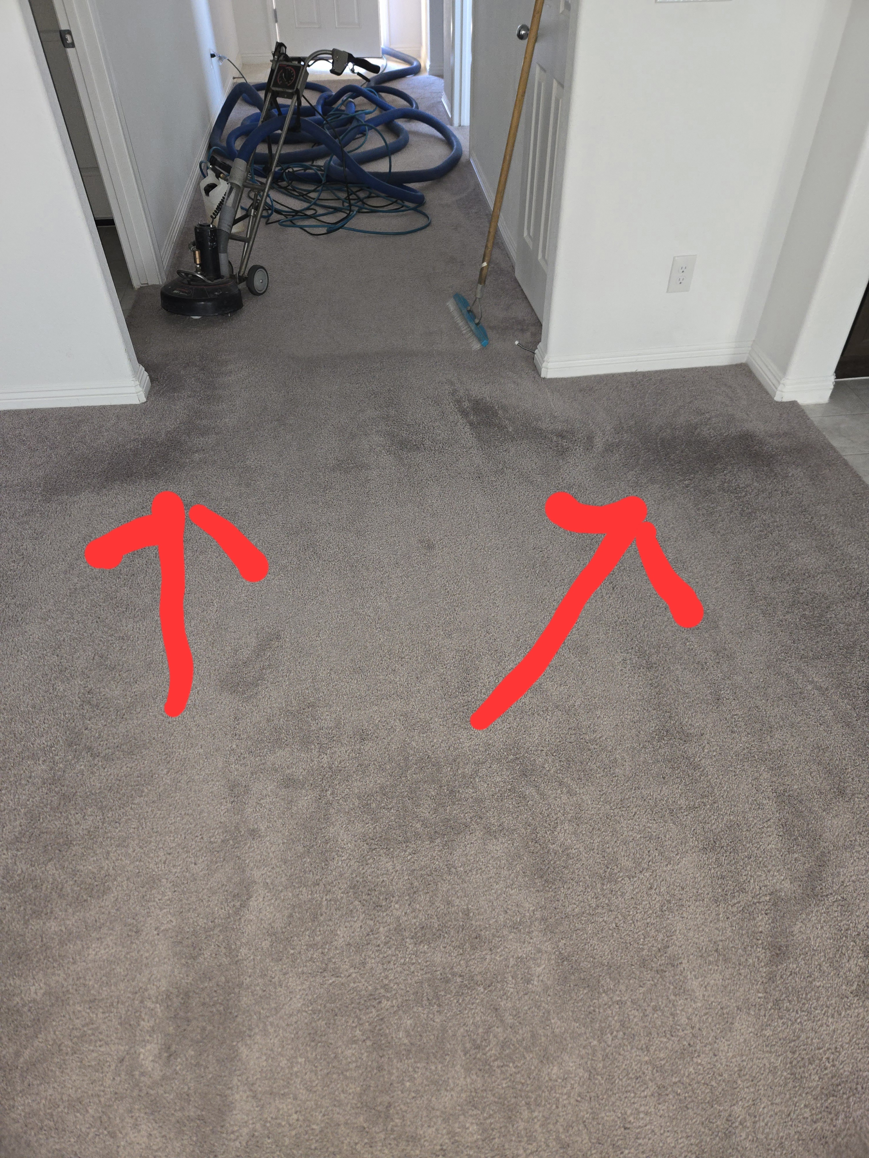

This looks like crap, all these housing tracks in my town have this crappy polyester carpet, a customer showed me a carpet upgrade and it was just a thicker polyester. 🙄 Has anyone used "Boost All"? My former Aramsco rep. told me to use it? I haven't yet...(I think it's just wearing and shading different.)

A good last ditch product is Harvard's Citra-zov powder. 12-13 pH. Contains oxy and citrus boosters. Cuts through just about anything.
Reactions: DrUmM@sT3r
50,002
Most likey, it’s not a prespray issue. There’s a thousand good prespray products and he’s probably already using one. In my experience, if a Rotovac with a brush head doesn’t solve the issue, then it’s time to replace the carpet.

Sodium per carbonate or powdered peroxide helps brighten the dinge and wear.
Bio spray 8 is loaded with it.
Also a polymer can fill scratches and help with wear.
Lastly clean the carpet and groom it in a direction that makes it looks brightest.

I would say about 10 years? Usually works great for me, I use a little Prochem Power Solvent for tough spots, but normally Flex, RotoVac 360i standard 3 jet head, brush head if it's really soiled, 400-500 psi, and full heat on the Prochem Apex...it's just these 2 housing tracks with polyester that I'm unable to get these dark pathways to blend? Nothing I try on it does anything? Thinking the fiber is just breaking down and I'm seeing wear shading? 🤷‍♂️ Just frustrating because it looks like I left it dirty....

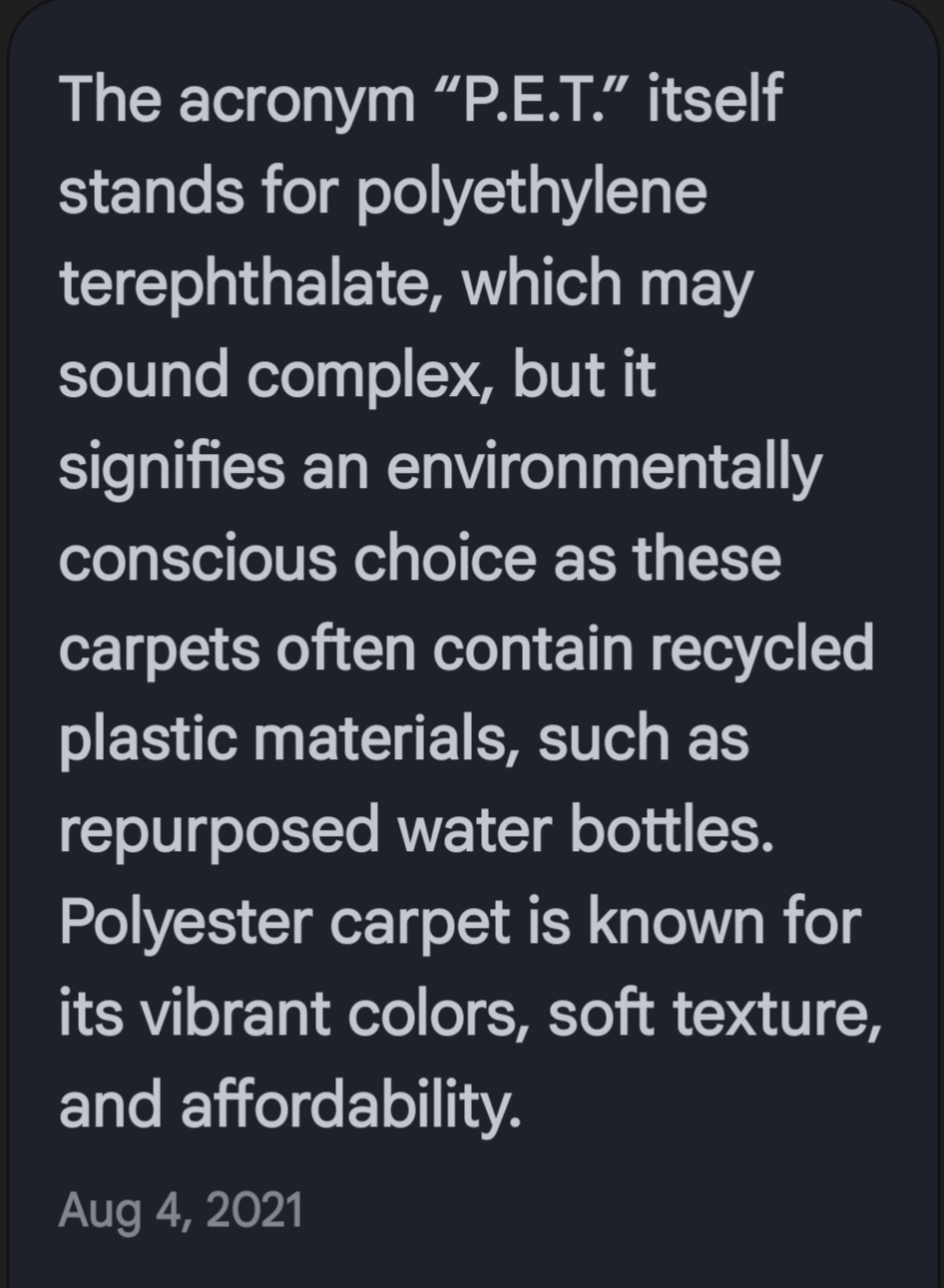

This polyester carpet is a good option for the homebuilder, as it's cheaper in price, but since the carpet is made from recycled plastic, it's not holding up very well. I remember my teacher at my IICRC class telling us not to purchase "Green Products". I'd say don't purchase green, recycled carpet either....
That's what I am thinking, most people here are replacing carpet with waterproof vinyl plank flooring. I have it throught my 2,300 sf home, it's easy, vacuum and the mop with hot water and white vinegar. 👍

To your question about Boost All
It will help a bit, as will similar Sodium Percarbonate products.
The biggest problem you have there is the damage to the fibers, which no magic prespray solution (Marty/Hogjowl said it well) can change.
While you won't find it in rental property, or mid-income homes, wool is coming back as a wall to wall carpet. It will hold up much, much better, and other than specific staining issues, you'll get it clean and looking good without needing to use thermonuclear presprays.

Sometimes dinge away from cti and fill scratches and brighten worn carpet.
But when the fiber untwists and looses density.
Or has pile reversal, there's not much you can do.
I agree wool is great, I still tell people get nylon.
