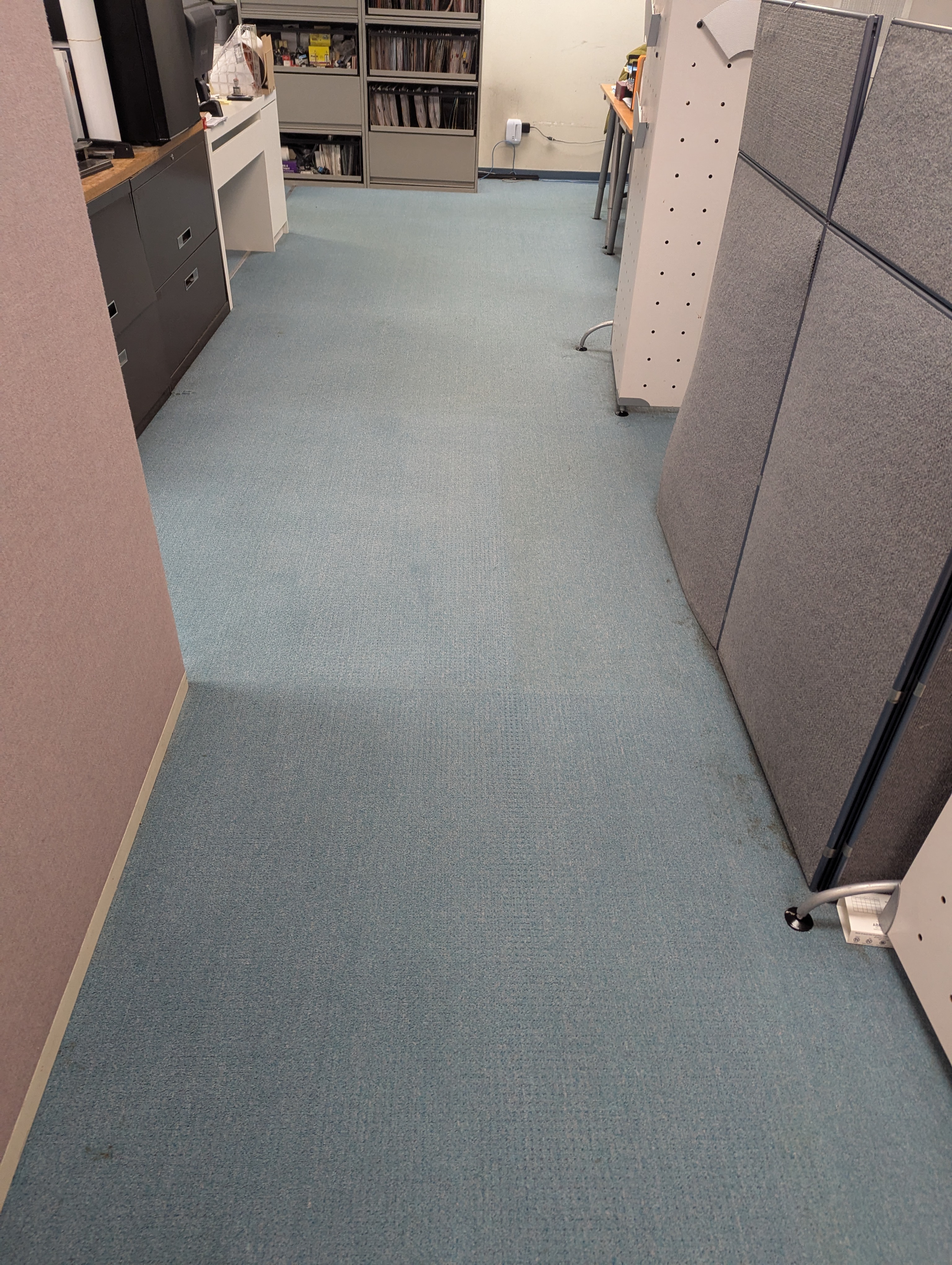

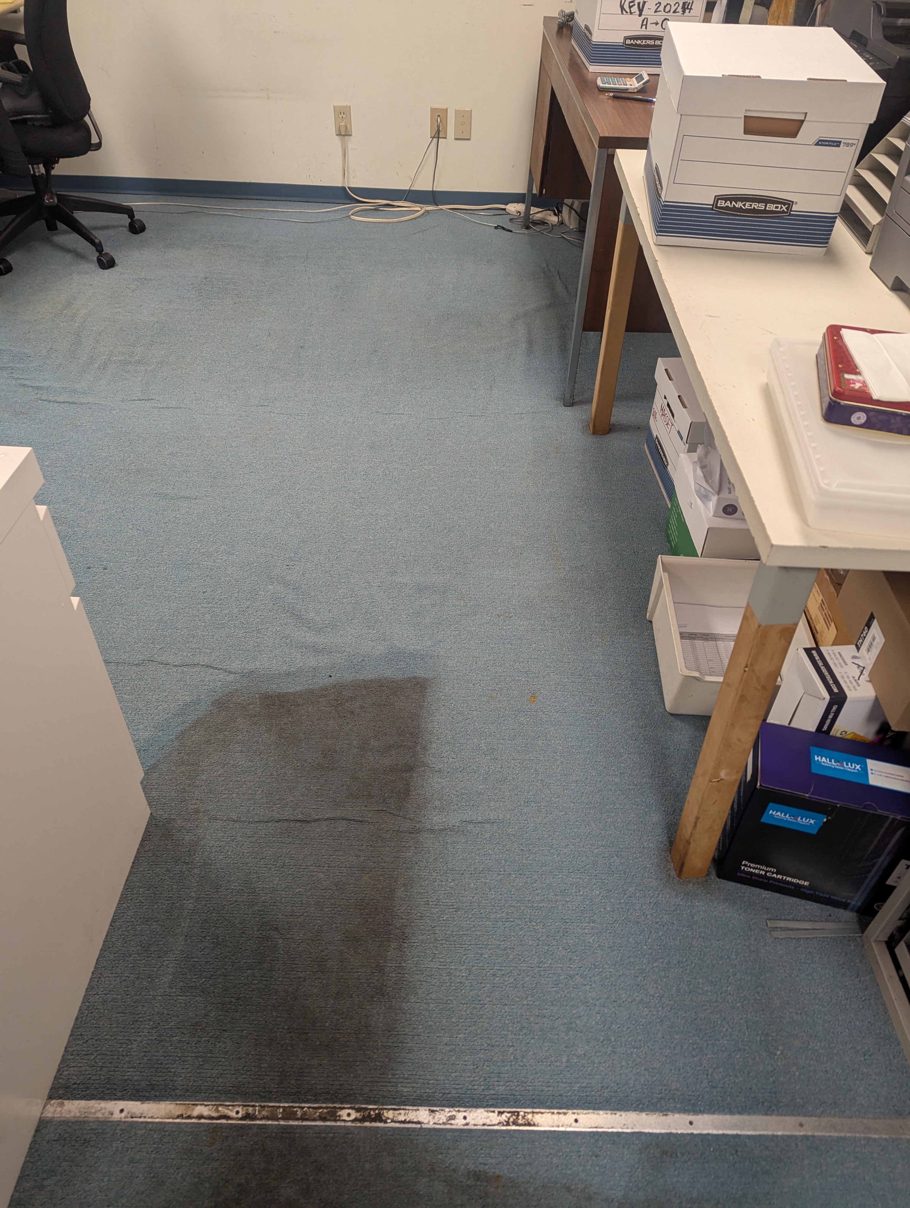

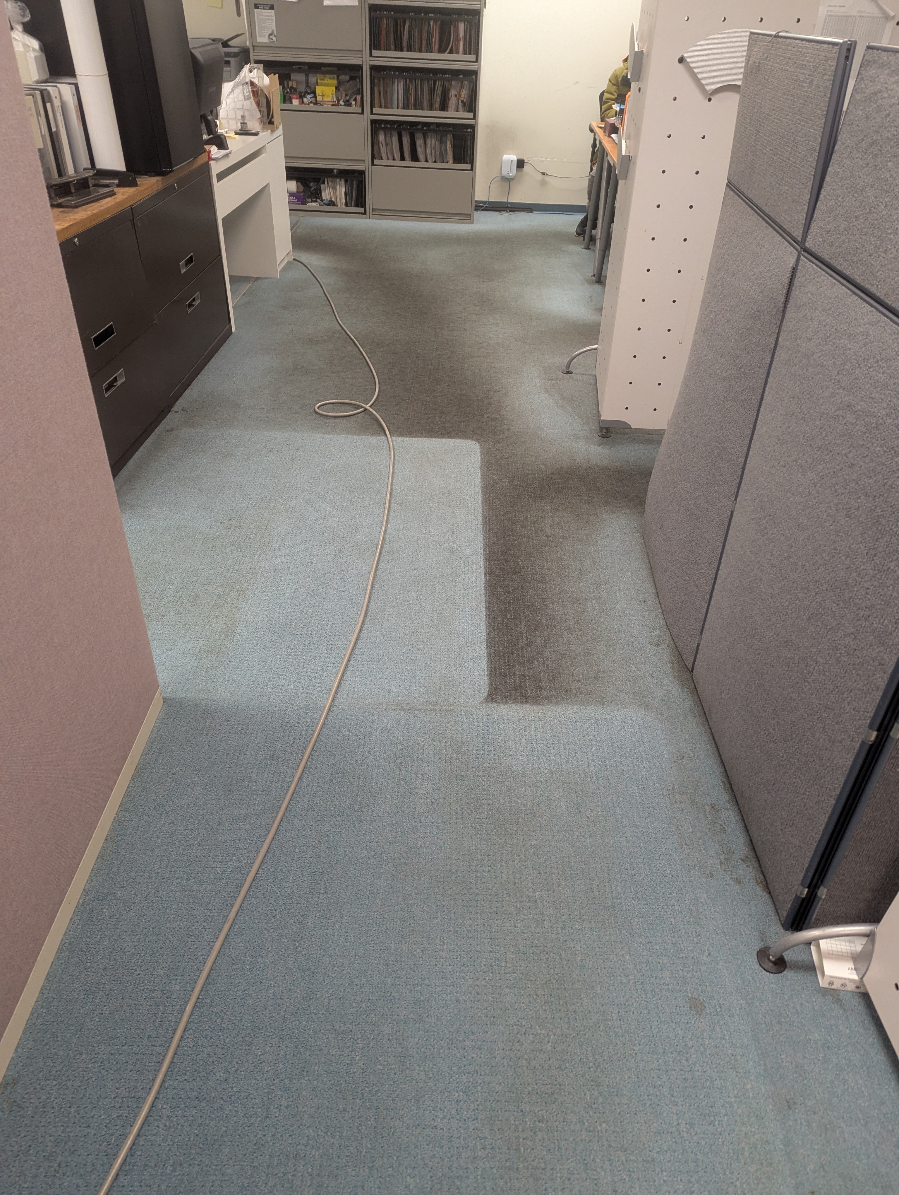

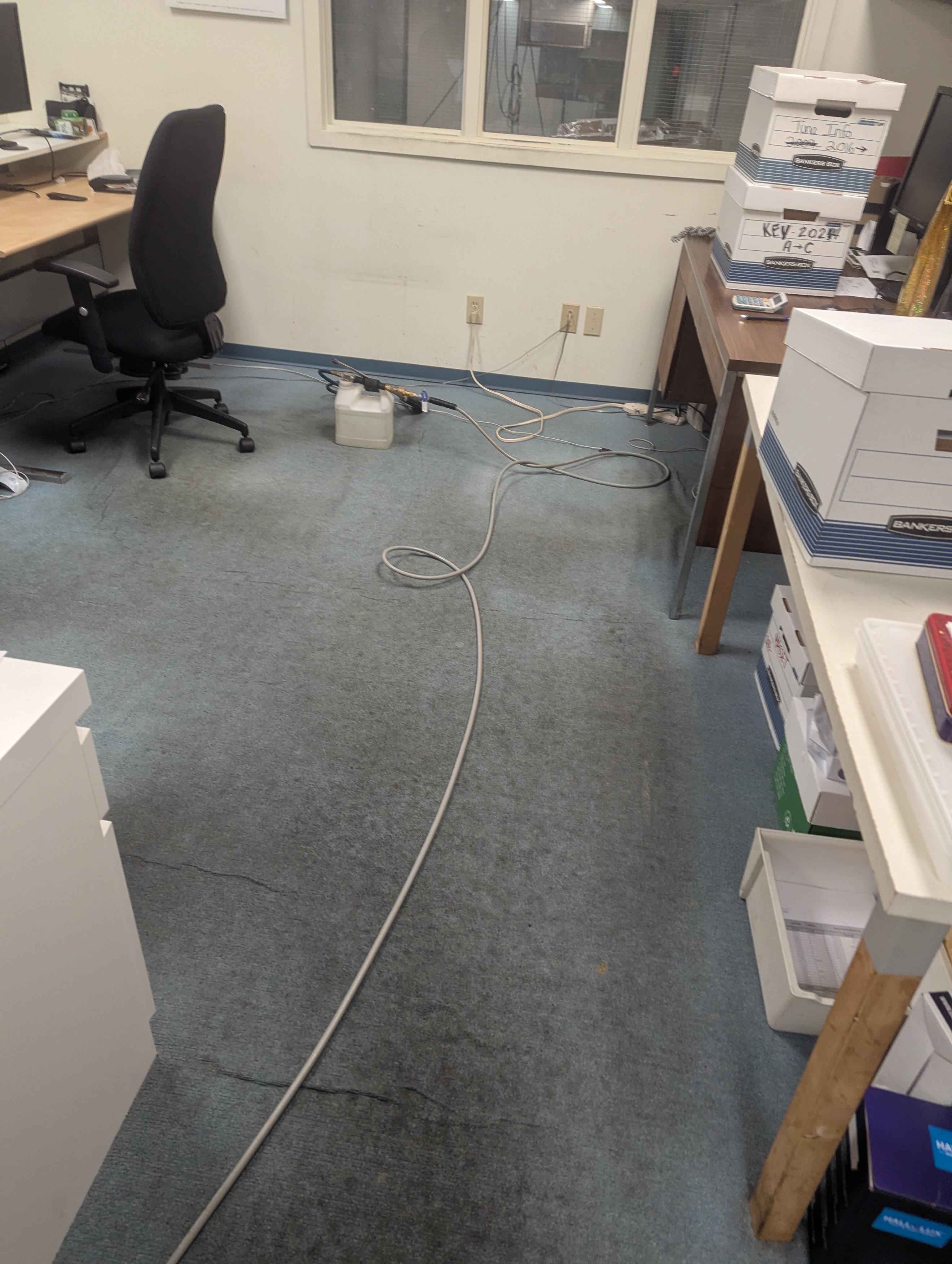

Here is the job I mentioned. Didn't have any hope of really improving it and let them know the carpet needed replacement rather than cleaning. Used Harvard's Citra-zov spraying with a 4-1 in-line sprayer and rinsing with Procyon plus powder. Prochem Apex. Had 5 Chinese ladies oohing and aahing over how well it came up.
