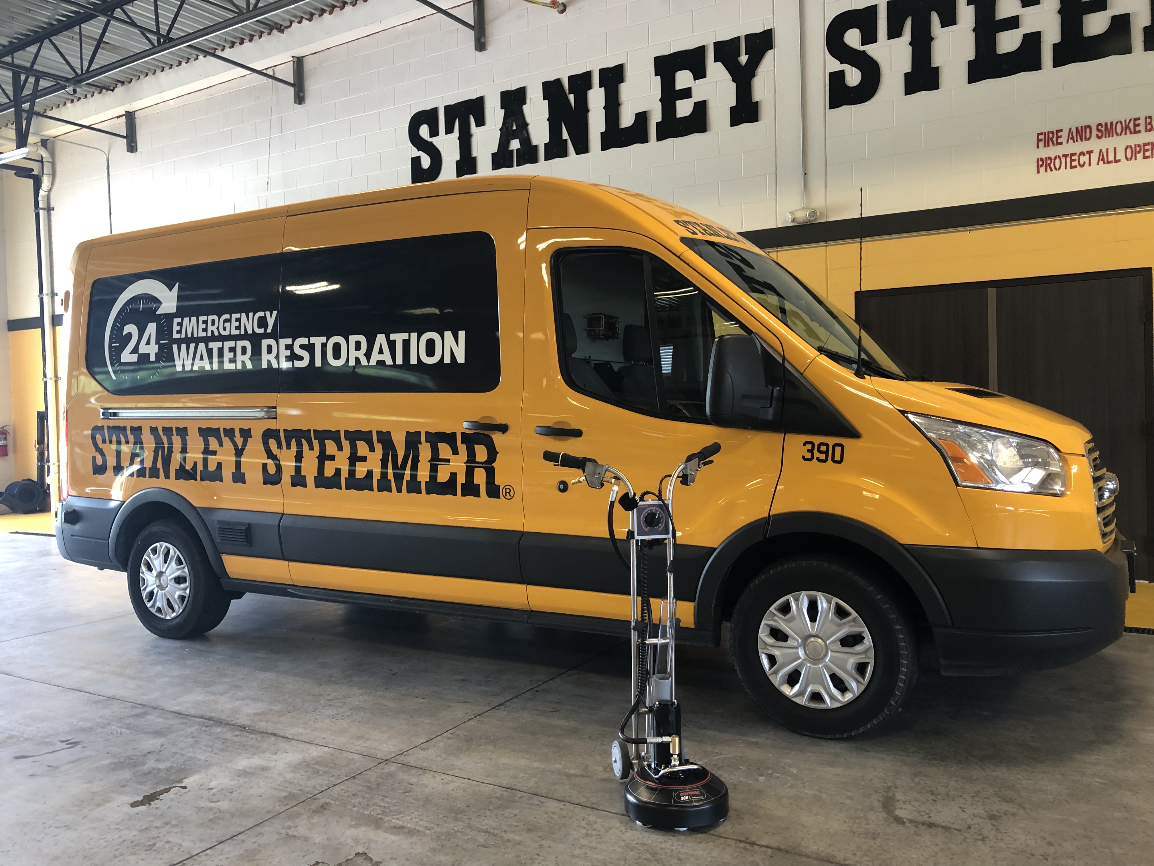

So, are ALL the trucks now so equipped??:biggrin:
FWIW, and not that it matters, I still use my original two head RV. When I got it many po pooed it . Work was it used too much H2O.
Using it mainly on really nasties, I found I could actually use less H2O. No need to hold the trigger open. Using it with a porty. Like I said , not that it matters since yours is paired with the truck.
But I put the prespray down heavy through the unit, with no vac where needed, for agitation. then when extracting , let the vac, and agitation do most of the work, just bumping the trigger.
