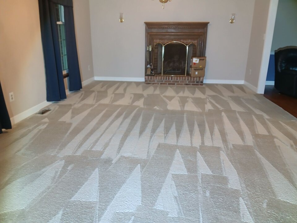

Long time customer. Living Room and Hall are always bad
Used VacAway Double Trouble 9.5 ph at 2 oz and 4 oz of Detonator (Peroxide) on carpet
I also cleaned the 2 Chairs Sofa and Lveseat
Thick dense carpet Clean and DRY in 1-2 hours

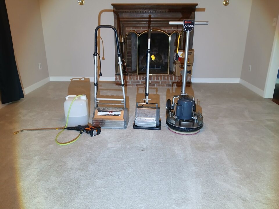

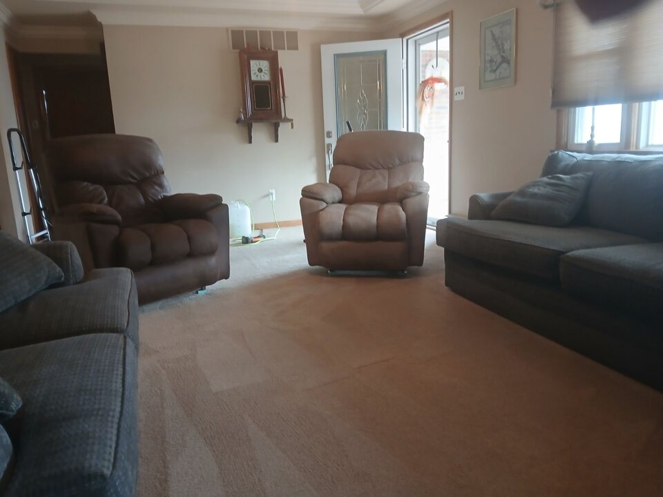

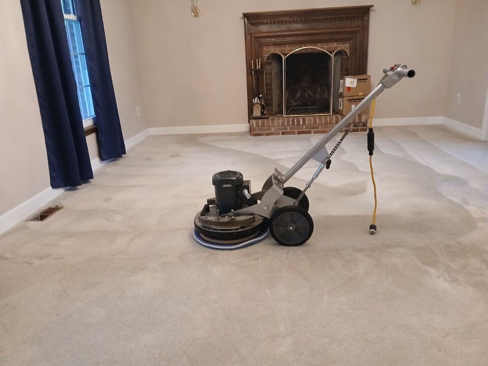

Nasty day outside
35 degrees Heavy Rain Wind Damp Cold and Miserable
But my Van Doors are closed and customers House Door is closed. No heat getting out or cold getting in
Working in Bad Weather is much easier and better using the VLM Method
And carpet will be dry in 1-2 Hours
One of the girls that works at my Apt Complex is moving into a new home and she asked her favorite carpet cleaner ME, to freshen up the carpet before she moves in
Nice Big House with Nylon carpet
I used Carpet Details at 4 oz and Detonator ( Peroxide ) at 4 oz
WORX Sprayer with 8003 Teejet
Light Blue Microfiber Bonnets and Tankless Vibe with 3 weights on each side
Soft White Brushes on CRB's to scrub and Groom
Life is BETTER using the VLM Method !!!

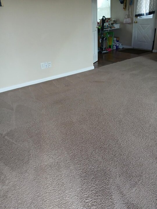

Yes it WORKS for ME
I've been trying for 11 pages to get your permission
I feel much better now about VLM since I have your permission 😀
LESS water MORE agitation !!!
