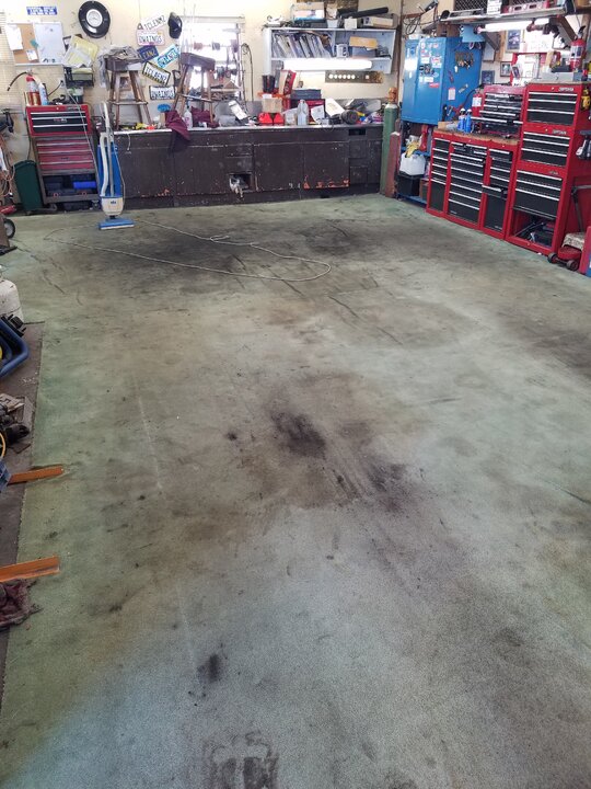

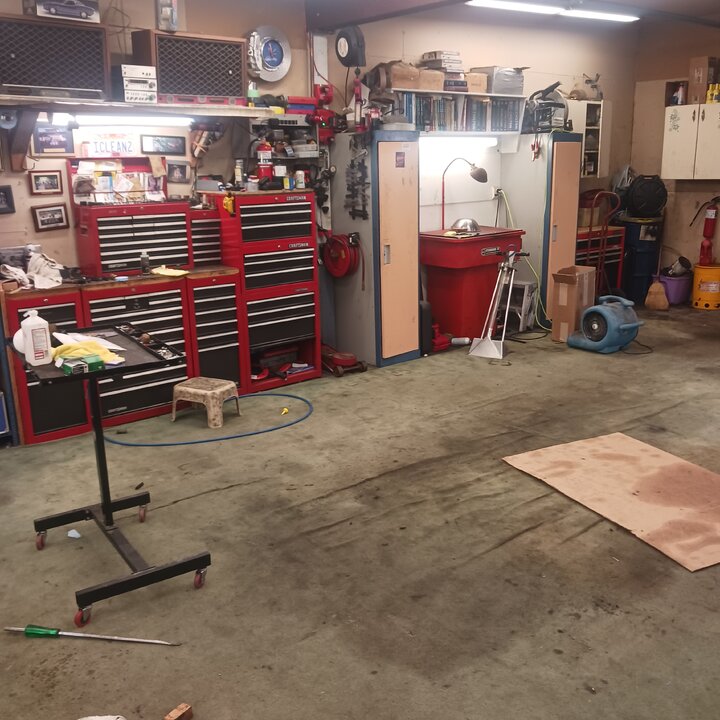

If this guy takes the challenge, we could certainly use a good judge
That carpet would be fun to clean! IT would take a minute or two to get it to look good. But i think i could make it happen.
In last 45 years of cleaning, i have done one or 50 of those , not hard to get it out ! Steam or VLM.

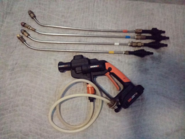

I don’t use an in-line sprayer much these days, though I will in certain situations. I’m pretty careful and controlled with how I apply pre-spray, but to answer your question honestly, yes, I’m sure that at times the backing and even a bit of the pad get wet.
Living the Dream with TOTAL Honesty
Thank You !!!
Have you ever tried the WORX Sprayer ???
If I was still HWE I would be using the WORX
They are reasonable priced and last a long time
You need 2-3 batteries just in case but one battery usually lasts all day, and you need to charge at the end of the day, but still worth it
Adding a Multi Sprayer Wand to WORX and teejet makes it the BEST Sprayer for VLM or HWE. My opinion
I have different wands with different Teejets for every situation I run into
I mostly use 8002 or 8003 but have 8004 8006 for big rooms so I can move faster or for trashed carpet when I need to put more solution down

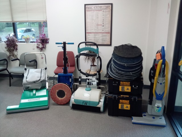

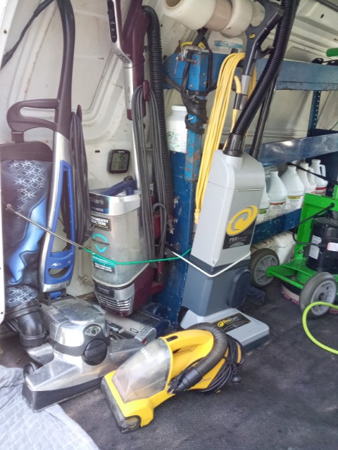

I probably have MORE money invested in vacuums than anybody here
How many guys here have a 28'' vacuum for big Commercial Jobs
Do you a 28 '' Vacuum ???
And I have more vacuums in my basement not in the pictures
Do you have a vacuum
How Many
Do you pre vacuum
Let's see your vacuum
