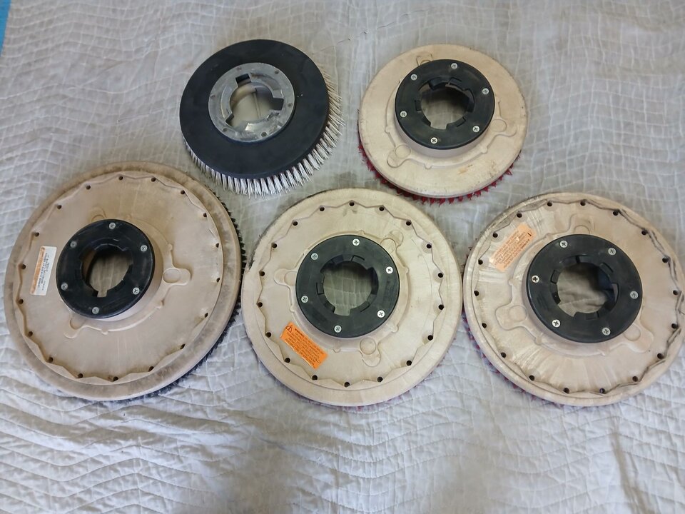

I have the 17'' Bonnet Pro Multi Brush and 14'' 15'' Drivers that have holes to shower feed using a Fiber Pad
Just got to be very careful near baseboards with oversized Driver
12'' Driver and 12'' Brush doesn't have the shower feed holes

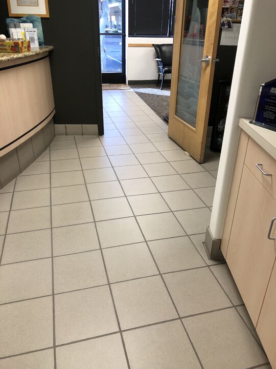

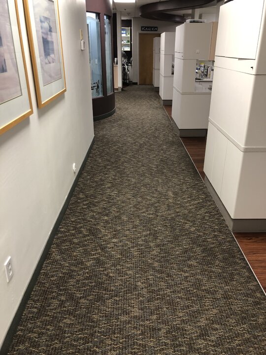

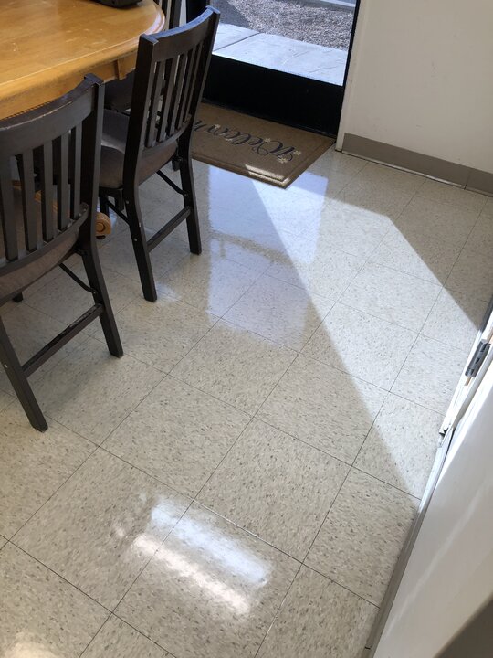

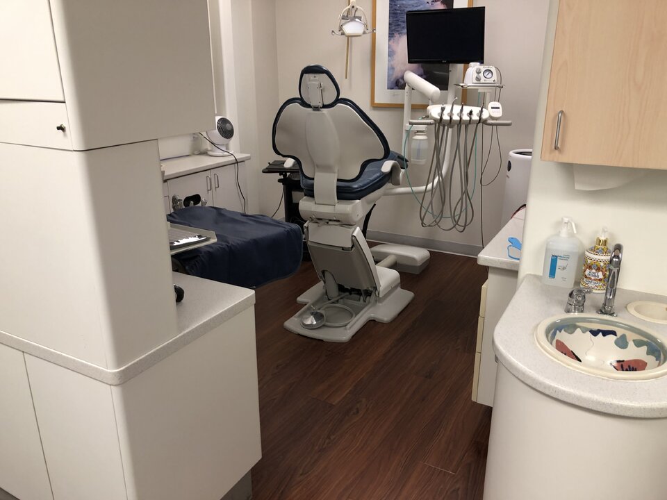

Fridays/Saturday job
Luxury vinyl, tile and grout, vct and cgd.
For clarity on the vct I used a square scrub and spp pad to do a scrub and recoat, so the round marks that look like circles are old.
I did the carpet with the Bonnet Pro Multi-Brush. It was fast and removed all dark travel paths tracked in from the asphalt parking lot. In Phoenix it's extremely hot for half the year and oils get tracked onto carpet. In case anyone cares I used Encapuclean and peroxide on the carpet.
I like the heat of the Ninja during the extraction, it helps in rinsing and removing the slurry off of hard surfaces so it doesn't dry to the floor.
One weekend I did a strip and applied 4 coats of finish on my first vct job (at another medical practice) and the employee who was supposed to be there took off for a couple hours.
Somebody came in and was in the file room going through their records when the employee came back.
The employee didn't lock up and had the audacity to ask me why I let them in, I told him I didn't let anyone in and I didn't see anyone come in because I wasn't in the area in question.
I like that a portable doesn't require open doors, letting me work without concerns like strangers having access to the building or my trailer.
