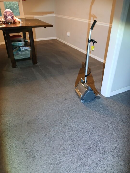

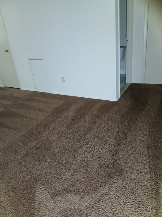

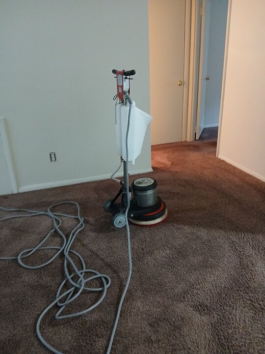

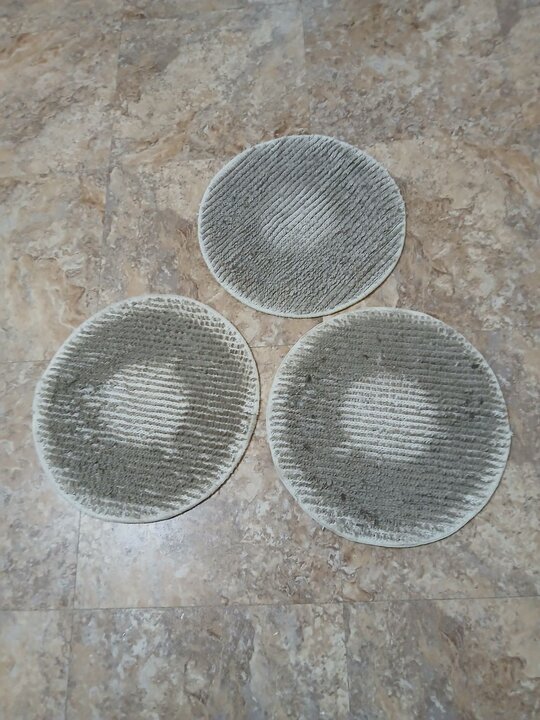

The first time using my 175-300 putting down solution from my tank was a total success
I just used 175 never used the 300
I used 14'' Red Pad on 14'' Driver to scrub and extracted with 17'' Ironman Bonnets. I used both sides of the bonnets
10'' CRB to groom
I used 5 oz of Carpet Details No Peroxide
I love VLM !!!

WOW!!!
Look at those pads!!!
But where does the dirt go????????? LOL

Carpet details is not a true encap as far as I know. Has no polymers. You should try Saiger's code red of encap. It's a liquid, easy to use, has a good amount of peroxide already, acidic in nature which makes it great for fine fabrics as well.
I was going to use Releasit or VacAway but I thought I might put down too much solution which would make the carpet stiff
Turns out I used less with the tank than I usually do spraying it with my WORX
Still never tried Saiger's
Carpet Details dries to a powder

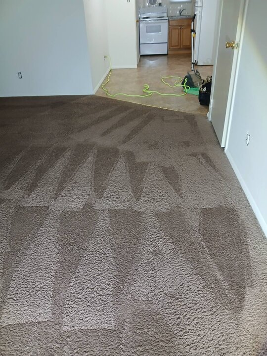

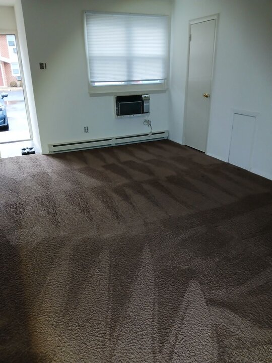

Maybe in Kneebraska it's okay, but here in the real world you'd be asked to fix it or badmouthed..

George,
We have, been doing it all wrong?
We need to flood the carpet!
Soak it really well!
And then put 10 or 12 DRY STROKES on it?
I think I finally GET IT!!!!!
I see the Light!!!!!!!!!!!!!
Yea another HWE Guy that's ANGRY
It's not about Corn Rows
They HATE learning the TRUTH about VLM
And SEEING the TRUTH
I warned the HWE Guys that have BLOOD PRESSURE issues to ignore this thread
I love VLM !!!
