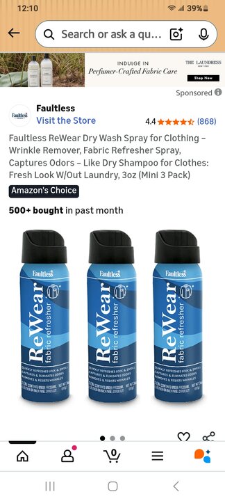

Here ya go just for you vlm guys. Vlm for your clothes! Only clean your clothes with this shit for 6 months or so and let me know how it goes. If you truly believe vlm is the only way to go then walk the talk.why are you wasting water and electricity cleaning clothes???my offer still stands that 100oz of silver is now worth $7,754.00 right now.
Terrible comparison.
Every instructor will tell you to limit the amount of moisture you put on carpet or upholstery; a washing machine soaks, rinses and spin dries in a way no extraction tool can.
Clothes don't have padding like carpet and upholstery, which we need to prevent from bleeding color or deposits onto the surface.
