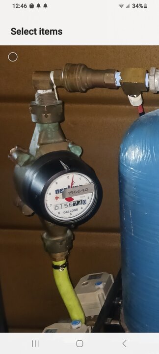

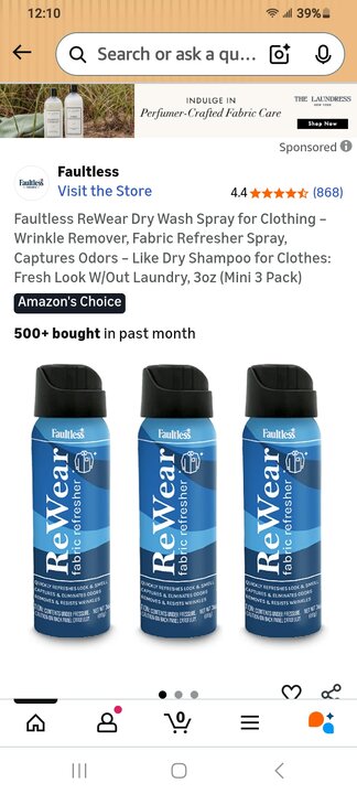

Here ya go just for you vlm guys. Vlm for your clothes! Only clean your clothes with this shit for 6 months or so and let me know how it goes. If you truly believe vlm is the only way to go then walk the talk.why are you wasting water and electricity cleaning clothes???my offer still stands that 100oz of silver is now worth $7,754.00 right now.

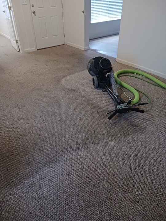

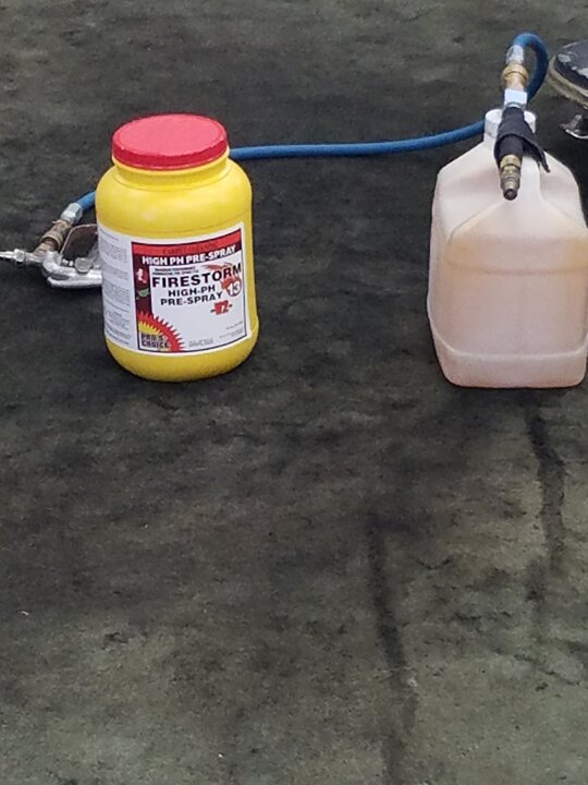

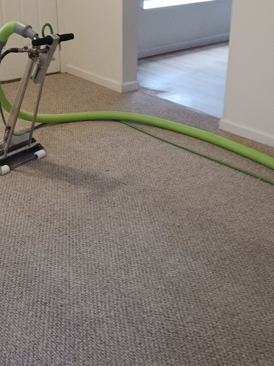

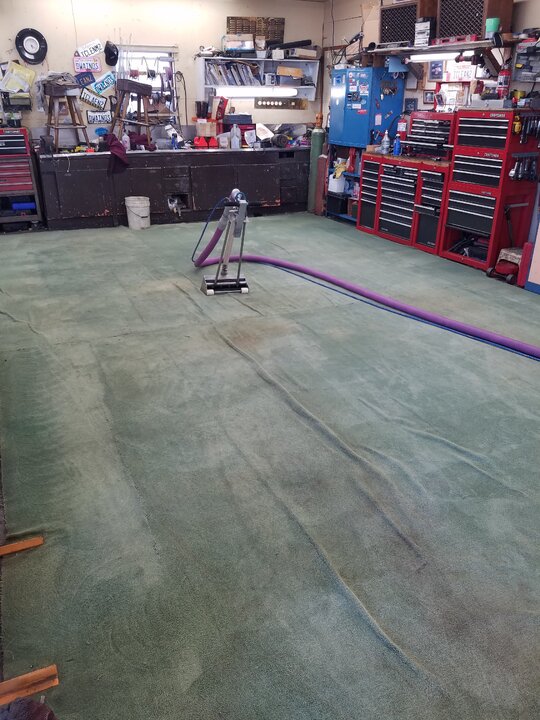

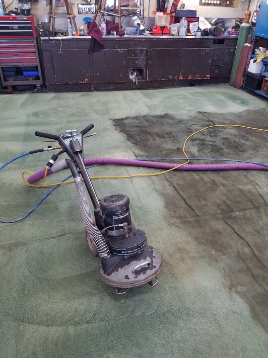

What ever you use to clean vlm use. Im going to prespray, clean and dry with an rx20 with emulsifier, then switch to a rinse then rinse and dry(with a second dry only pass) with a drag wand . Just as i do on all carpets i clean. I will also document the amount of water i use so you know no tricks i really did flood the f$@k outa it and achieved the best results

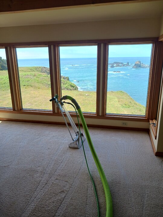

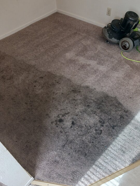

If your sitill up to it after all that i know of a couple of apartments that i can always do count on to be dirty and ill give you a rematch there afterwards. Same conditions , outcome very very public and video documented . Any body using just about any process can make a clean to mildly soiled carpet look clean. But it take professional with professional hwe equipment to achieve excellent results with a dirty carpet. One thing you have to understand beforehand is that living in the country i specialize in carpets that most other eighter can't or won't clean. In a rural area you can't pick n choose which carpets you clean if you only cleaned the high end barley dirty ones you would be outa business in a very short time. I do do the nice ones but for every one of them there's 10 of the butt that ugly nasty ones to do(but on a remach we ain't goin to no nice one. )

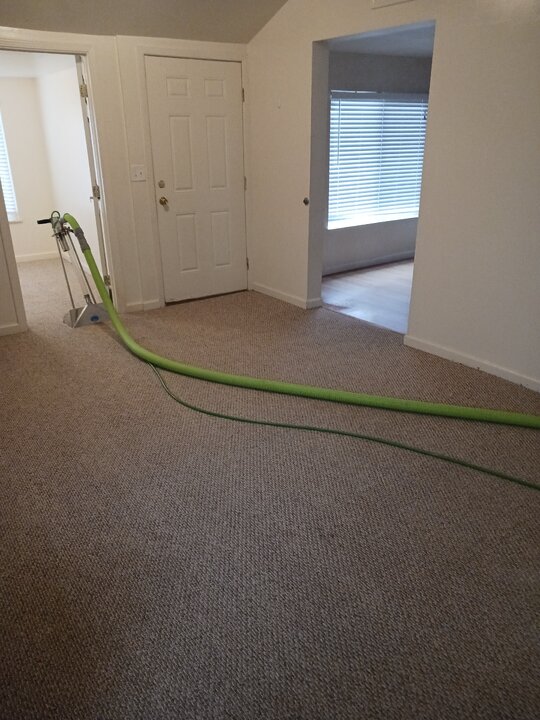

We do the shop first then an apartment we'll test um both after and the next day if you want but the results will be videoed and made very very public on 3 forums. you obviously never seen or used or even know what a drag wand is or can do)it is 16" wide, weighs 39lbs sprays 1.25 gpm and will pickup virtually everything it puts down at a standstill . I have documented my process so you understand exactly how ill clean and when we are thru for the day and the equipment is packed up theres no touchup going back the next day lets do it but so you know and no crying foul at the outcome below is a picture of how clean a drag wand can clean. So keep in mind thats how clean im going to clean a carpet ive just cleaned with a rotary come on down we might even be able get Mikey to judge he only lives 5 or so hours away
View attachment 133569 View attachment 133570
YES, I owned a drag wand back in the 80s
I even made one of my own in the early 90s
NO cleaning in your shop.....
